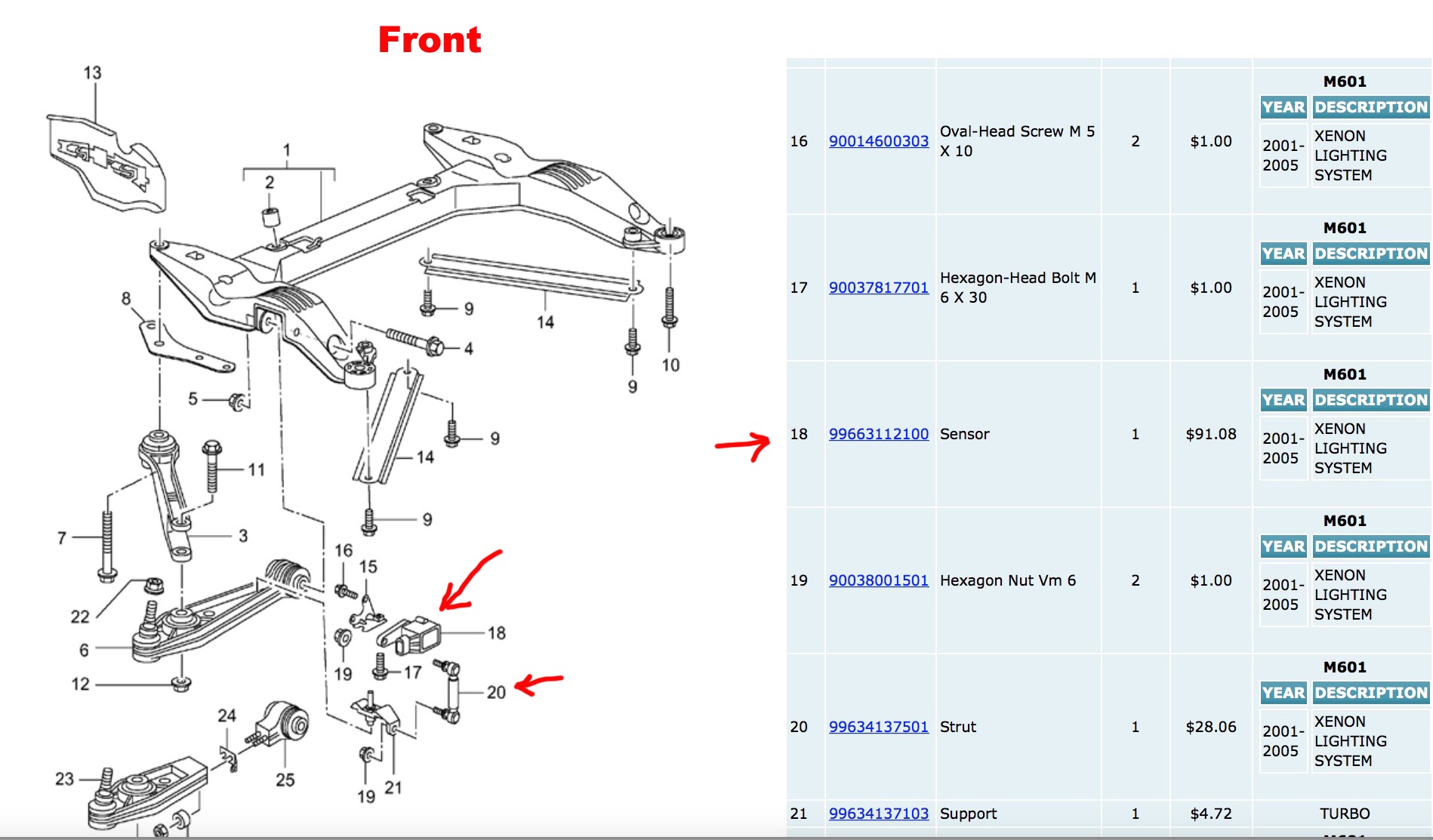

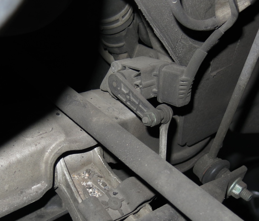

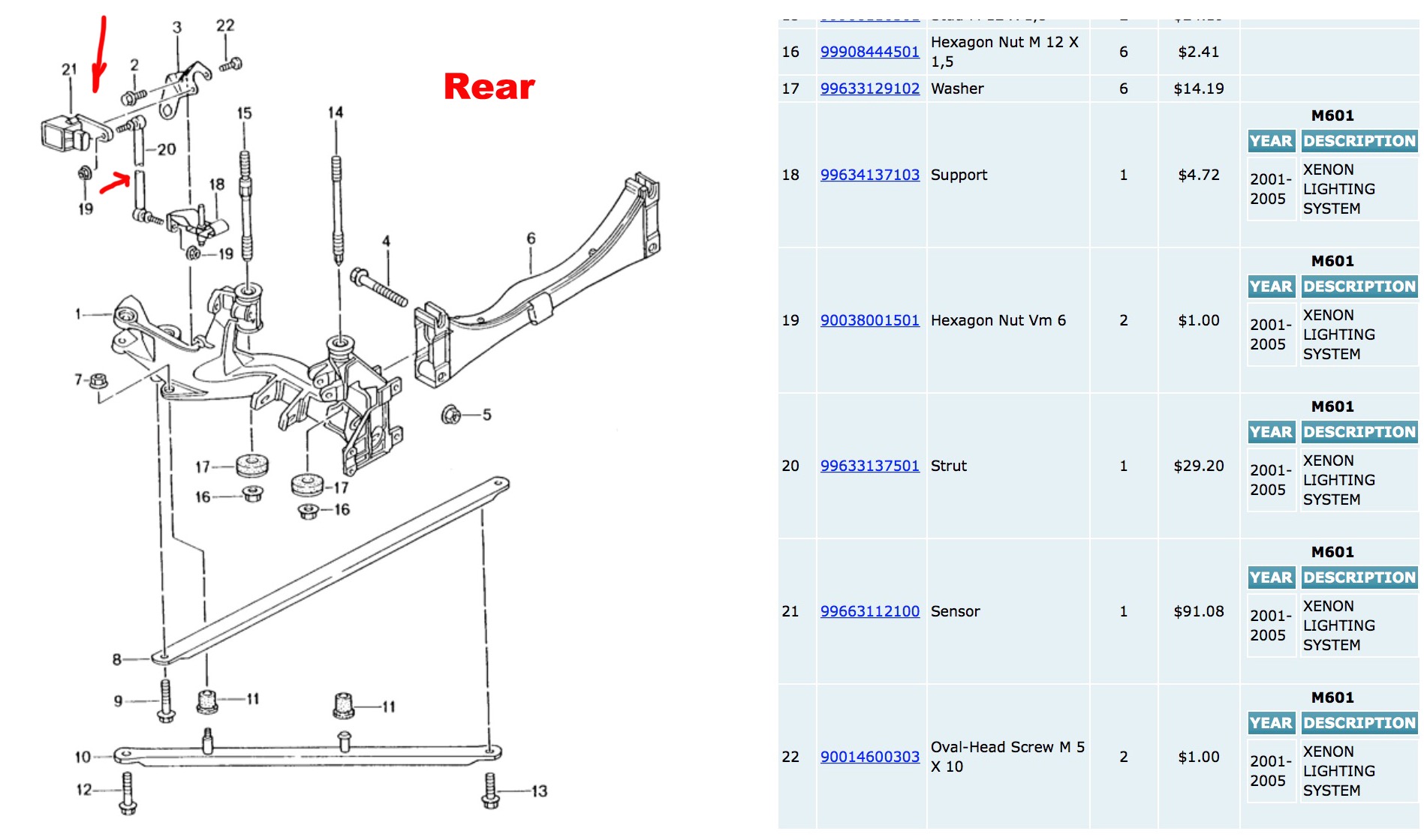

You better check your level sensor located on the suspension. May be you got a broken arm.....I think the rear one is on the left side and the front one is on the right side....

The front one is good. Didn't know there was a rear one. I'll check it out.
