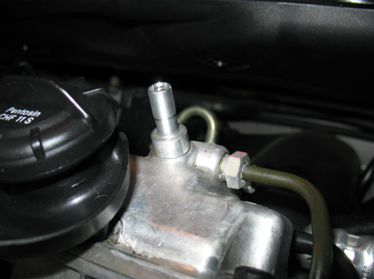

Before I went to the track the rear steering reservoir and the front reservoir were set at the MAX line so I siphoned the pentison out of both and set both of them to the MIN line so I knew they were not overfilled and went to the track and it still leaked pentosin out of the small valve on the rear steering reservoir onto the engine.
I'm not sure what the small valve on the rear steering reservoir is that has the green tag around it, but I'm guessing it's to relieve pressure when it gets to high in the steering reservoir system.
Do you think maybe it is the steering pump?

On my way back from work this afternoon I am going to try to blow air into that valve to see if it is blocked. You will do the same thing and found out if our cars are the same way. I suspect it should be blocked and only open in case of over pressure. But let see first if the valve is ok. If everything seems fine why not getting that fluid completely replace with new one. May be the fluid is contaminated and the boiling point is too low now..... Remember you only got that problem on the track when the steering system is in high demand.. Cheap first attempt to fix your problem.
The valve on my steering reservoir in the rear has a green tag around it and a small rubber or plastic cap on it that if you push down on it the cap will move down slightly them spring up to its original position, It seems to be working right because that is were the Pentison is coming out of when the pressure gets to high.

Starnge????
I also changed the fluid about 7 months ago so it should be fine.
I don't have this "spring up" valve device you are talking about. My valve is completely solid. The stem doesn't move and I tried to blow air into it and it is solid. And yes I am talking about the valve on the steering reservoir with the green flag ?????? Updated valve???? My car is a 2002....
Your valve is definitely different than mine. My steering reservoir was replaced a year age, it could be I have an updated part.
