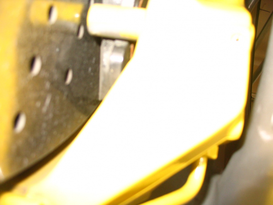

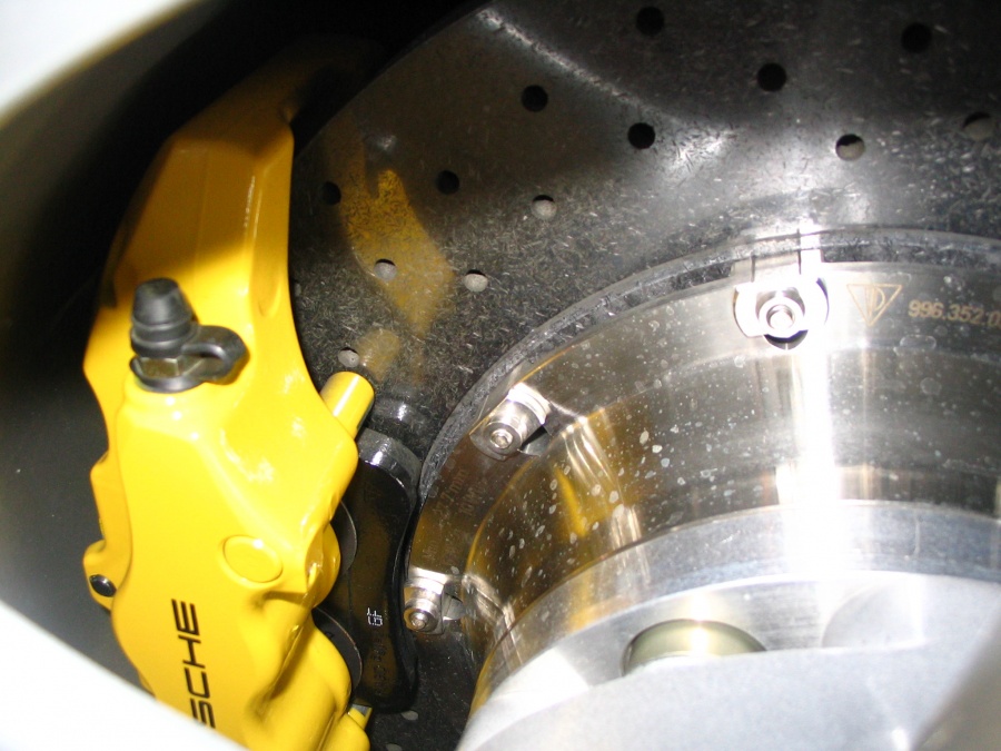

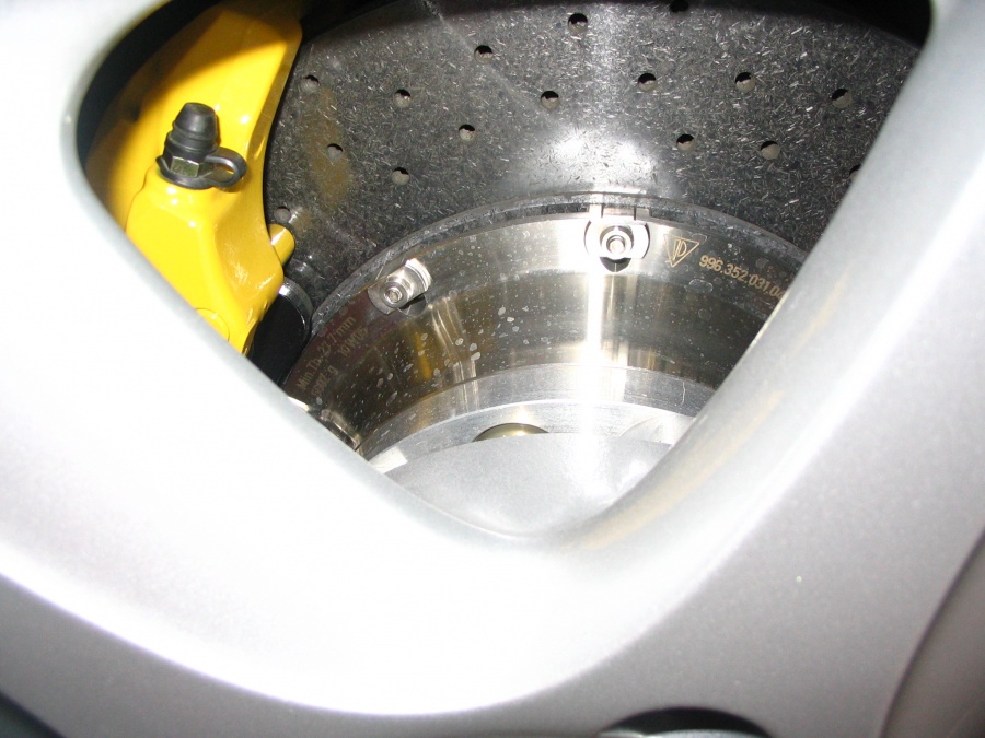

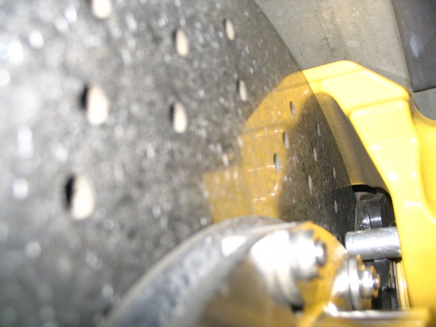

Wear depends upon driving habits. One driver can have a set last 150,000 miles (many hwy miles) and another 25,000 miles (around town miles). Have a dealership calculate the wear before you purchase. I attached my Gen 2 PCCB's with less than 100 miles so you may compare for your self.
