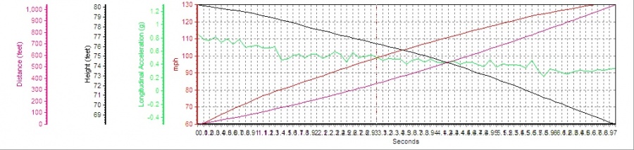

So I took the car out yesterday to see what she does. I did a 1/4mile pull. With a 2.2 60' time I managed to run a 11.5@130.2 However, I noticed that my car was doing 60-130 in 7.8 seconds! My car is taking 1.9 seconds to get from 110 to 120. After looking over a few other runs this happens every time. Anyone know what could be causing it or anyone with a tip know if this is an inherent issue with the tips. Will a TCU upgrade take care of this issue?

I am completely lost with this thread, can you help somebody who would like to learn something this morning. First, what tool did you used to come up with this graph ( two graphs ???). And what are the gray( high peak = shift???), red, blue, yellow lines. Thanks for the information....
I believe the OP used a Vbox, which you can produce these graphs from. By plotting the g-force, you can see the shift changes.

Ok I've heard about the Pbox but of course I have to do some more search about it. I'm still using sandclock ....Thanks a lot 996ttalot.Originally Posted by 996ttalot

To compare your graph to tip car. I seached and found old graph from VividTX. (60-130 6.57 sec)
https://www.6speedonline.com/forums/...4&d=1253474057
One thing I see, your dip in the shift is .3sec. But there is more than dip in your tran that effect time. Check how VividTX car pulled strong&smoth through each gear. G graph in each gear did not drop much between mid to high rpm. Your graph is kind off taper when it reach higher rpm. May be run out of air or choke somehow.
