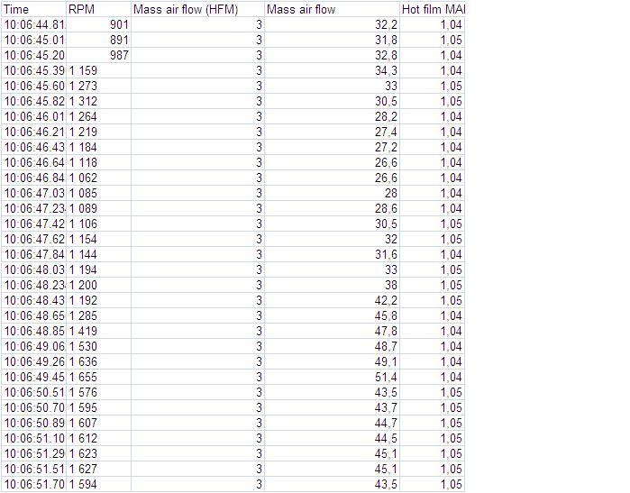

Thank you,
Please see below some log.
I got solid "3" at Mass Airflow (HFM) and changed by RPM Mass air flow.
Hot film Maf is also very solid.
Any comments about other parameters of MAF?
I read here http://forums.rennlist.com/rennforum...isleading.html
that other parameters of MAF also should changedby rpm and load.

I would really need to see a run up to 6500 on boost as well to confirm that it is all okay.

Your MAF sure does look dead as a dodo to me Dominik.

I agree but still need to see all the way up the power band to be absolutely sure.

I replaced MAF, please see below logs.
so theoretical if one value of maf log is constant (solid), its means bad Maf
Now car running good.
Thanks
