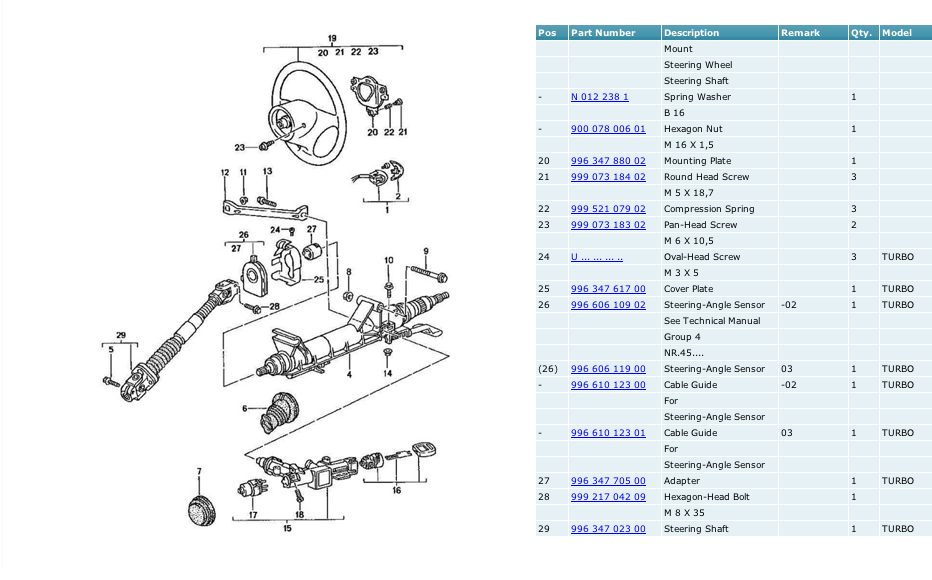

Hello Guys from 1 hour ago my cars shows me on dash ABS , PSM OFF , and i checked the Ecu , and its shows Steering Angle Sensors ,
So please guys any one can help me where to find it ? please online or good company ? to order rite now im out of the states?
and this is the part number 996.606.109.01
car model 2001
and this is the picutre and the reason why did i put the picutre because i bought one and its was wrong , this is one right now , so please guys any 1 can tell me how much it is , and where can i find it?
http://img121.imageshack.us/img121/7...4241704edd.jpg

Your part# does not work, the number available at Pelican is for the MY02, as per Porsche parts cat is 996 606 109 02 $241.75 may be Suncoast... Give them a call 877.923.1700
Better check with them if part is compatible with MY01....

Did you have any work done to the car ie Allignment or anything with suspension or steering? The steering angle usually needs to be programmed by the dealer.

Look here seems to be applicable: ,http://www.pelicanparts.com/cgi-bin/...DANGLE%20SENSO

Adam is wright, you need PIWIS to adjust this ensor. Durametric doesn't have this function

i tryed with the reading there is no reading because the steering angle is totally damaged , no reading about the steering wheel , and no connection with any reading about the steering adjust
and i checked with the dealer and they told me the steering angle is damaged
but here they costs me alot arround 1300$

It's hard for me to judge with your picture but there is many parts that are modified between MY01 and later model. May be it is an improved parts.... I personally would like to check my part# with Porsche dealer or Suncoast to be 100% sure....

yea i know what do u mean , but i bought one like this one excaulty
and the dealer told me that will not fit because the plug is different

$1300.00 ????????????? If you look at the porsche part# for MY2003 #996 606 119 00 this one is a lot more expensive $834.25....

Porsche parts cat....
Look at item # 26

yea man im rite now in the middle east so im fu,,, up with the prices everything is expensive here not like the states
and as i think not this one , because mine is 996 606 109 01

yea bro its the item #26
but didn't fit on the car because the plug area is not on the top its on a side
