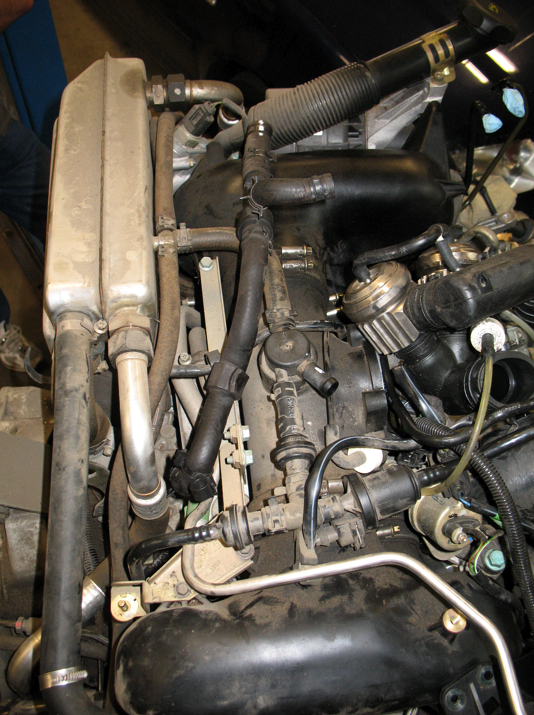

My '03tt dumped coolant yesterday in a big way just cruising along. Just a little squeek squeek squeek (from the belt?) and the check coolant light coming on. Immediately pulled over and had a puddle under the car. Towed it home last night. The expansion tank looks fine. When I pour water in, is comes out IN A HURRY somewhere on the top of the driver side bank. I pulled the air filter housing and the bottom of the tank & lines are all fine. There appears to be 3 lines from the water pump running up and over the motor under the manifold. My best guess so far is one of those split in a huge way or a clamp worked off. So my questions are:
What do those lines go to? It looks in PET two might feed the water heater lines but I can't really tell.
How much of a pain is it to get to those? Can it be done from the top or is a motor drop prudent?
Are there other more likely sources that it'd be leaking from? I can't even sneak a borescope in to see where the leak is. That stuff is packed in there.

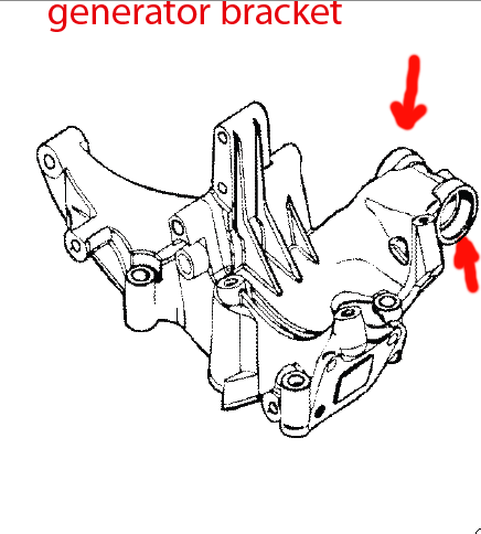

Take a good look a little further forward. I saw once a strong leak coming from these seals...see pic...The pipe was not line up properly with the casting and finally damage the seals.

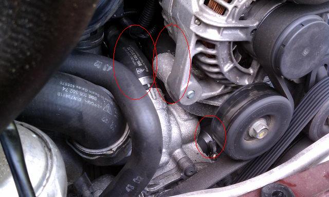

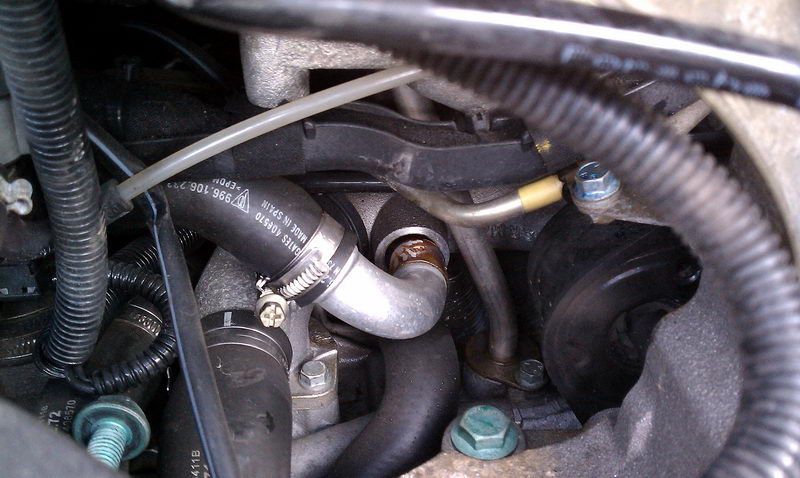

Pics...
To situate you may be those pictures can help....

Thanks jp, those pics help a lot. The pic from PET, I can see the heater hard lines 19 & 21 in your pic too. Im wondering if its one of the short hoses 20 or 23.
From your more top view looks like a bunch of stuff is going to have to come off. I pulled the bolts for the alternator but the right side of it won't wiggle free easily. I need to search/read up more on if I get it free are the wire going to be slack enough to pull it fwd (at least enough to then possibly disconnect it.) Looks like that *MIGHT* give me an access window.

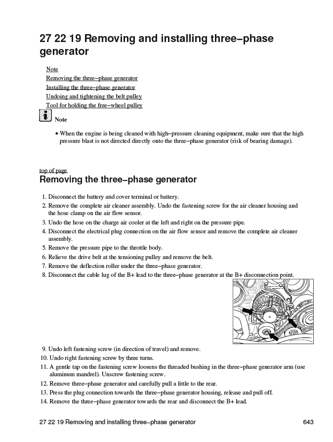

I guess you got access to the repair manual If you do, remember Porsche call it a Generator. To facilitate your search.... Page 643.

Yes, I have the manual. Gave it another go after lunch (and a nap I finally got the gen moved fwd. FWIW, If that aluminum bushing on the right bolt hasn't moved in 7 yrs no amt of "gentle tap"ping is going to get it to move back I eventually wiggled/pried it and up and over. There is plenty of wire to pull it fwd w/o disconnecting. The loose fitting was then staring me in the face...
Now how to fix it! The elbow appears to have been bonded orig. Wonder if I can rebond successfully (and w/ what) or should I just replace the whole housing.
