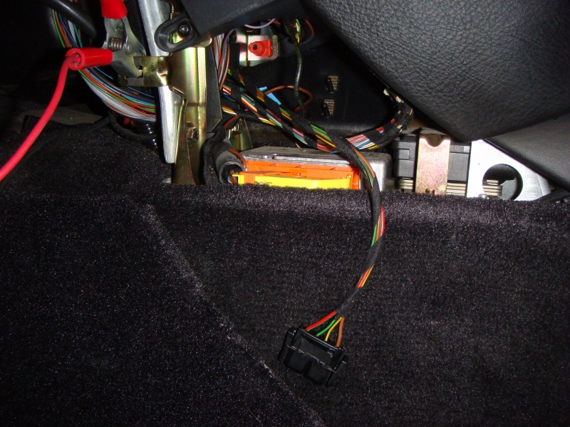

SubscribeOK, so I get all ready to install Bluetooth in my 01 TT. I crack open the cover on the right side of the gas pedal. I'm thinking, I need Battery, Switched power and a ground. As soon as I pull the cover, I see this...
Does anyone know what this is???
I measure the voltage and find that the Red is Battery, the green is switched power and the brown is ground. How lucky is that?
So I tapped into that connector, but I would like to know what the connector was originally for.... Anyone?

If it is what I think ,it is switched/unswitched power for the cell phone option. It is there on all cars. Others use it for radar power. I used it to power a Tire Presure Monitoring System...and I love this car also

OK, confirmed - the yellow wire is the radio mute. Not only does it mute the radio, but it writes: "PHONE" on the Nav display. Too cool - and way to easy for this upgrade.
That means there must be an audio in somewhere on the back of the deck for the phone system to broadcast voice through the factory speakers.....can anyone solve for this? If so, we can easily integrate bluetooth capability in this car
I'm thinking that if Porsche was expecting the phone to have audio out, those two wires would have been included in the harness (pic 1) so it would be totally plug and play. I'd also bet I could tap into the Nav audio with those wires if I could find out where they were.
