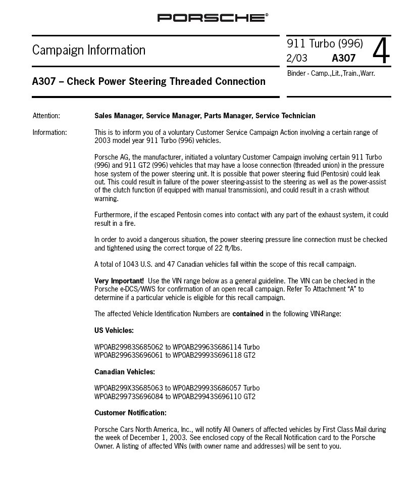

There is two technical service bulletin mentioning power steering system. First A307, can cause a leak due to a faulty pressure line going to the steering pump and the second the famous whistling noise #4897 cause by a vibrating pressure control valve. But there is no mention of leaks! Also a low fluid level can cause whistling noise from the pump....
