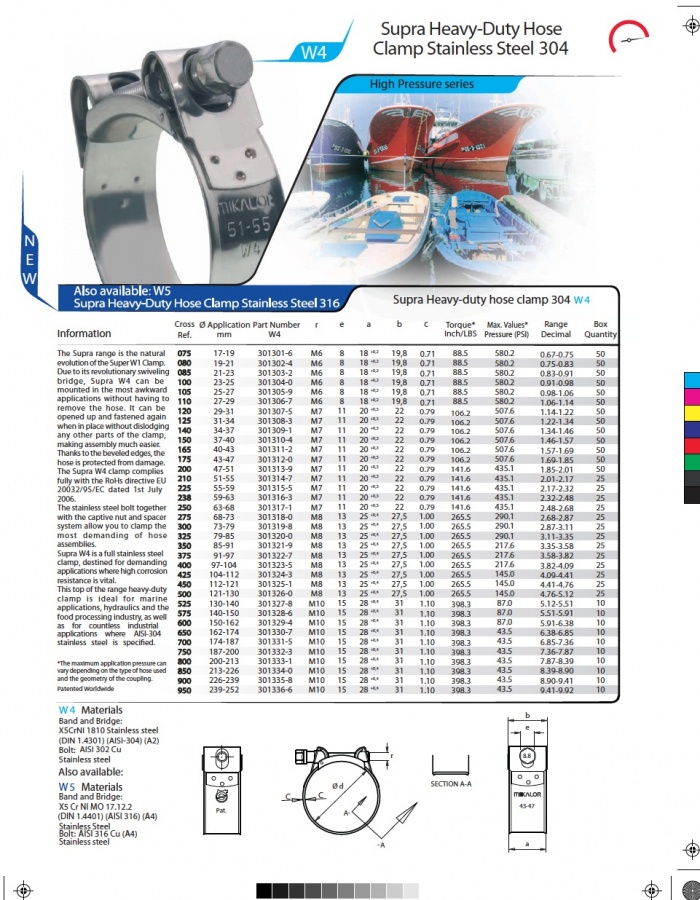

I had Agency Power hose with fitting not line up properly. So I had to cut the clamps and reposition the coupling. For clamp replacement I've found some on Ebay. "Mikalor" made in Italy. There are simply perfect. The delivery, from England, was really fast. That's the seller I used and the size I had to used was 59 to 63 mm. I took the W4 which are all in stainless including the bolt.
http://cgi.ebay.com/ebaymotors/MIKAL...#ht_1471wt_829
