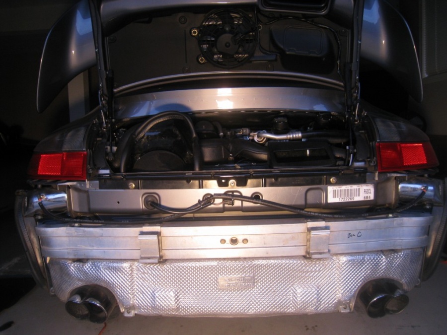

Hi Cory,
Use the Aquamist HFS-6 kit, that is what I am using.
As you can see I have installed my jets on the end tanks of my EVOMS IC's.
I have done about 80 runs on the Coq highway fine tuning my system and continue to
Ben
PM me your email addy and I will send you more info from the write-up that Ian did.
