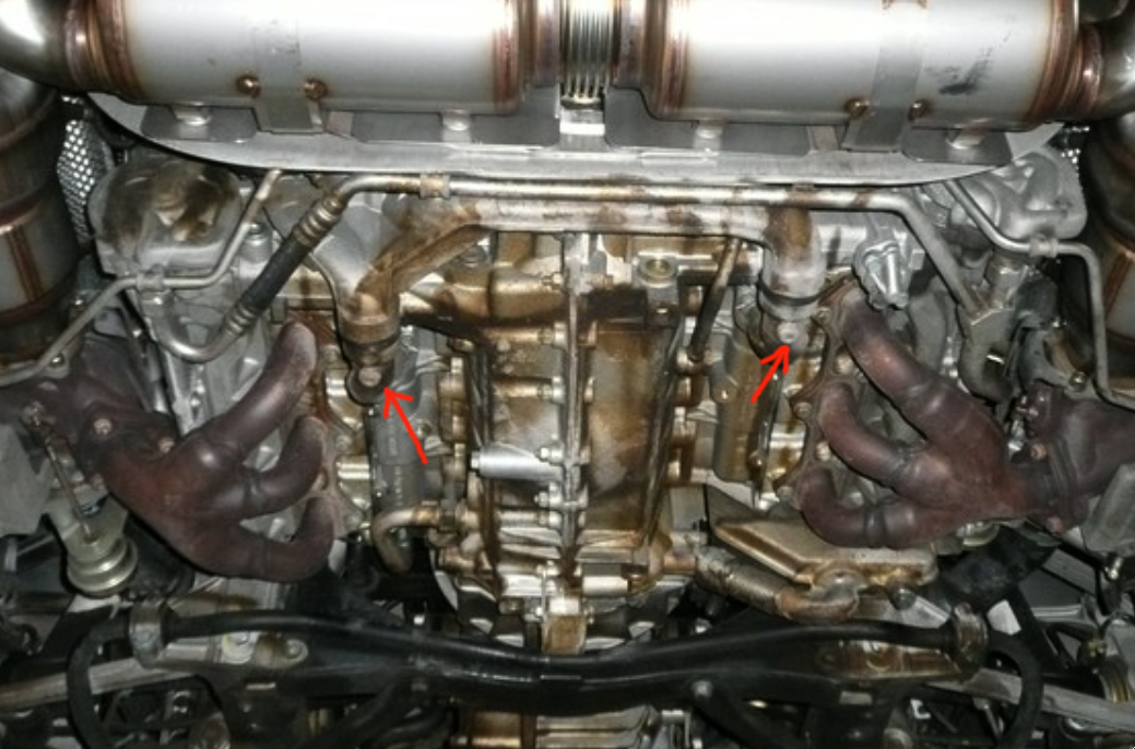

I cannot find where the drain plug is for the coolant! Can anyone tell me where to find on a 2001 TT? TIA!

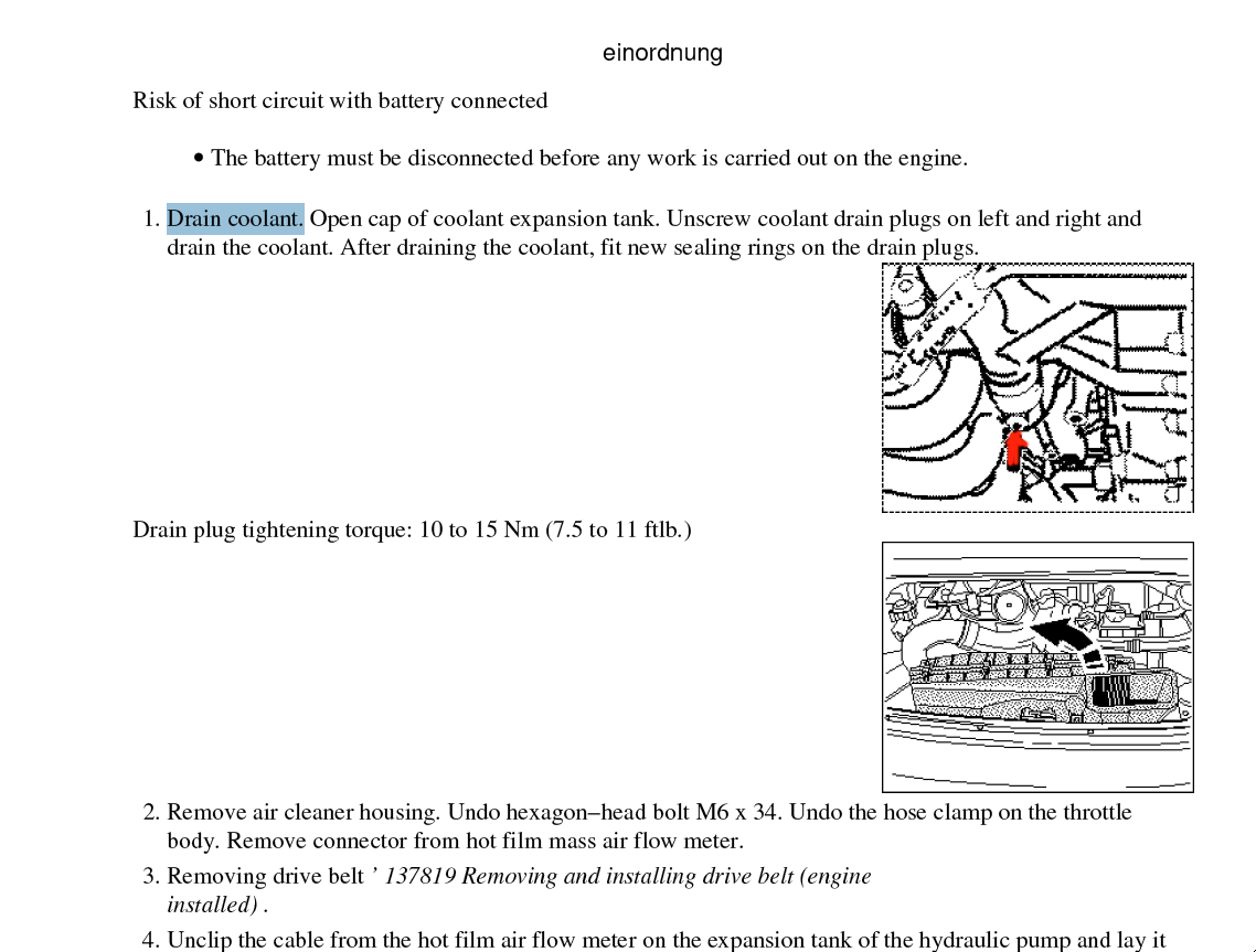

This is the plug mention in the repair manual. Is it the one you could not found?
Never done it but looks like the two possible points....

Thanks, that's what I guessed. I loosened it and coolant came out, so I went with it.
There are two, drivers side (which I removed) and passenger. I just went with one so far.

Just in case you don't have the repair manual....
Thank you, Thank you!!! I am so happy right now, I would hug you.
