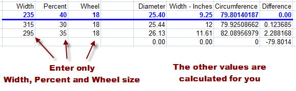

I have seen this kind of thread a few times now, so I thought I would contribute by posting this tire calculator that I use to determine what size tires would be appropriate. It is an Excel spreadsheet where you enter width, percent and wheel size and it will return tire diameter, width in inches, circumference and the difference from the base size.
File Type: zip

Tire calc spreadsheet is very handy but you really need to check out the specs for each individual brand of tire...despite the same "size", the dimensions can be very different (e.g. a 225/40/18 can be the same rolling diameter as a different brands 245/40/18). Re OP, you should be OK if that is the actual spec difference between the front and back.
