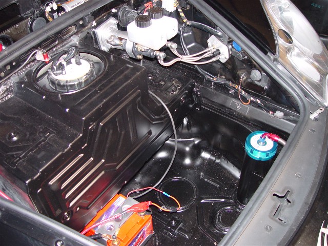

The PSM was disconnected and removed from the car. The ABS was disconnected and removed from the car. I switched over to a dual master cyclinder allowing me to adjust brake bias(works great compared to stock bias settings).

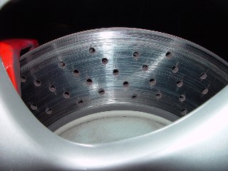

Some more pics as per your request. Stock rotor abused at Sebring.

Dual master cylinder w/ cockpit adjustable bias. Sorry the car's a little dusty from Sebring yet.

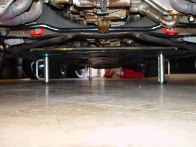

Air Jacks with locking stands. Picture's a little fuzzy.
