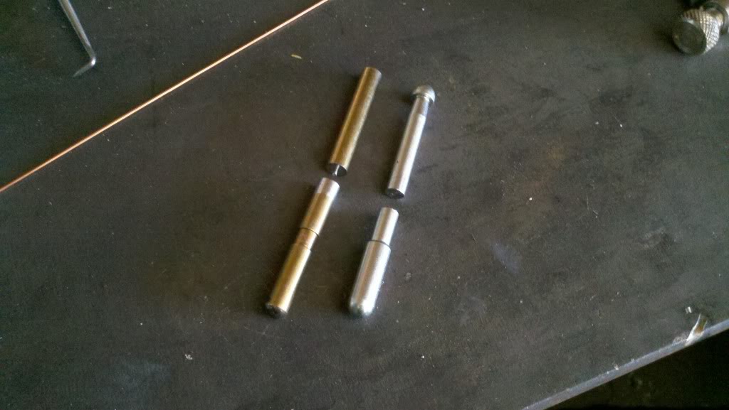

So I'm having this GT2 clutch slave conversion done, but my installer saw some notable issues with the shaft for the clutch slave cylinder. Since the OEM one is held in with a boot, and the GT2 one is held in with a stop machined at the end, he said it was silly to use the OEM slave cylinder shaft that could and would simply fall off into the bellhousing (either during installation, or during future servicing). Plus it doesn't even sit very well when it's shoved into the new GT2 slave cylinder. For comparison, the rod on the left is the OEM slave cylinder shaft and the rod on the right is GT2 one. Both have already been sectioned...
He basically sectioned the two pieces with a lathe and created one (via tig welding) that would not only stay in the new GT2 slave cylinder, but would also point straight out for easier installation alignment..... the best of all worlds! The overall length is the same as the OEM slave cylinder rod. Here is the final product:

I had a local welder do this also, including extending the rod .5" for a higher engagement point.
Yeah, that explains why some folks had been posting before that their engagement point was pretty far down when you press the clutch. I am willing to bet, that it was installed with the original GT2 rod.
I think the best thing about doing this is when you take out the GT2 slave to replace it the next time, that OEM rod won't have a chance to fall into the bellhousing which would be a nightmare!

I kept the stock boot on the shaft and used a two pieces of electrical tape to hold the boot to the new slave. That way I didn't have to hold the shaft. If I ever remove it, I can still hold the boot. The welded shaft is a good addition. I was going to make a new shaft on the lathe but got lazy.
