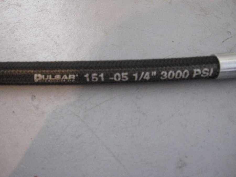

GT2 hydraulic hose 996 423 377 90 ($115.25) this is optional build your own for $25-$30 I will explain below.

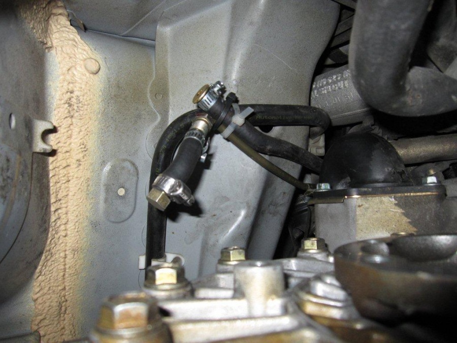

Now for plugging the two most aft lines. Evoms cnc’s their own threaded plugs as it is impossible to find I tried but it is not necessary to use there method and frankly mine is easier. To find where evoms wants you to connect to you need to follow the two lines way back towards the engine compartment and if you look hard enough you will find it but access is really difficult. Heres my method, the line with the quick connect on it cut the rubber hose at the end of the plastic connector, so as to save as much of the rubber hose as possible and then cut a second piece off about 2 ½ inches long. Take that “second piece” and find a two bolts that you can thread into it snugly, (doesn’t matter if their metric, standard, smooth, brass or bare metal as long as you can thread it in) I had a bunch of left over bolts from previous projects over the years and just used 2 that I could thread into the rubber hose line. Install one bolt in the cut line under the car and use one small adjustable hose clamp to help it stay their. The “second piece” of rubber hose (2 ½ inch) that you cut off install the other bolt and TWO adjustable hose clamps, tighten one hose clamp over the bolt crawl under the car and push it on the hard line over the double flare end tighten other hose clamp to stay in place and ziptie the lines off to the side and out of your way. See pic below.
These two lines are completely dead, as no pressure flows through them because you removed the drive coupler in the power steering pump. All your doing is stopping any residual drips and dirt from getting into the lines.
Ok so now you have removed the power steering pump pulled the drive coupler in it, reinstalled the pump capped the two most aft lines on the oem slave and removed it as well as the accumulator. Your almost there.

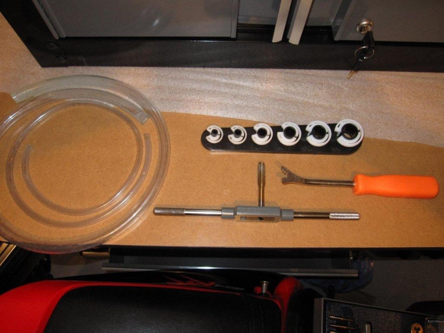

Now that the line is clean and dry DO NOT REFILL YOUR FRONT RESERVOIR YET LEAVE IT EMPTY you need to install the new GT2 master and assist spring. Remove your drivers side floor mat and place a towel down to help catch any remaining dot 4 fluid but in my case there was none thanks to the power bleeder. Remove the a/c heater duct (just pulls off) remove the two bolts holding the oem master on and pull the two clips holding on the hoses. The pin holding the push rod on to the clutch pedal is simply held in place with a brass clip remove this also. The assist spring is just clipped in place both at the pedal and at its mount, just pull it out.

Now to the hydraulic hose that connects the hard green line under the car to the new gt2 slave. If you decide to buy the gt2 hydraulic hose the line is to short and will need to be extended. So build your own for $25 bucks, here’s how. Take your old hydraulic line from the oem turbos slave and your new gt2 slave to your local hydraulic shop, tell them you need a 16 inch dot 4 resilient line that’s 3/8 inch inner diameter and ½ inch outer diameter the part number is 100r5 #4. If they don’t have this you can use 151-05 which is ¼ inch inner 5/8 outer diameter slightly larger but works just fine and both lines can withstand 3000 pounds of pressure . See pic below. Ask them to move the large two piece coupler off the old turbo line (connector on the left side of hose pic) and install on the new 16 inch line, and get them to find a connector that matches the new gt2 slave threading. Total length of hose and connector should be about 20 inches.
You just saved $90 bucks! But if you don’t want the hassle of them not having the one connector buy the gt2 hydraulic line and get them to move both connectors to the new 16 inch hose.(remember total length with connectors is around 20 inches)
Next you need to tap the new gt2 slave as they don’t come threaded. Use a M 10x1.5 tap and the tip is use a vise to hold the slave still so you thread it straight.

First pic is plugs, second is new hose, third is close up of hose, fourth is helper bleeder hose, tap, a/c fuel line tool for quick connectors or use panel pulley (orange handle) both work
