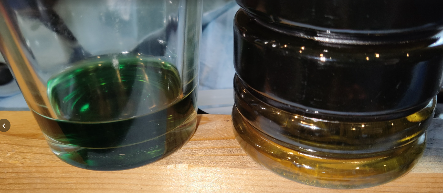

The PS reservoir has a filter membrane, in it,, which turned out to be a good thing. When I sampled the PS fluid in my system, couple things stuck out:
1. The fluid level was low
2. The fluid was very oxidised with rubber black having leeched into it
3. Looks like the dealer topped it off with the wrong fluid with a different density, it sat at the bottom of the bottle when I emptied the reservoir!!!
New Vs Old:

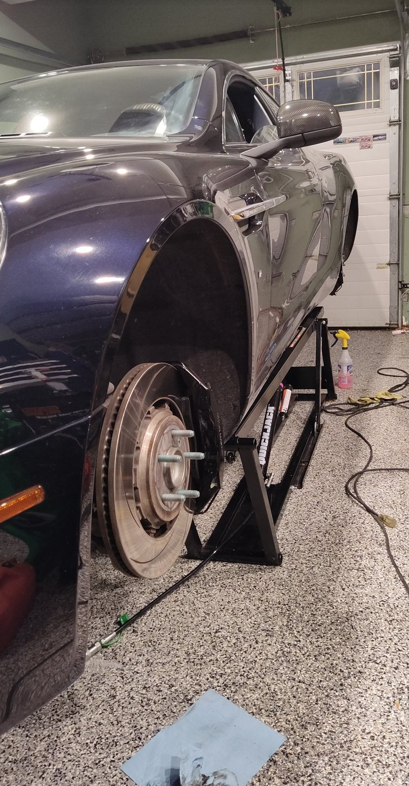

I went ahead and emptied the OE reservoir, removed the Oetiker clamp and plugged the return line to an empty jug so I could flush the system. By doing so, I was able to add new fluid to the reservoir, and pump it through the system by turning the steering wheel and even running the pump for a very short time. I did so until the liquid on the return line was clean and new...
You will need a 1" Oetiker clamp... Here's old vs new (post-install):
Plugged the return line to a jug and cycled the fluid through with steering wheel action until new CHF 11S was on the return:

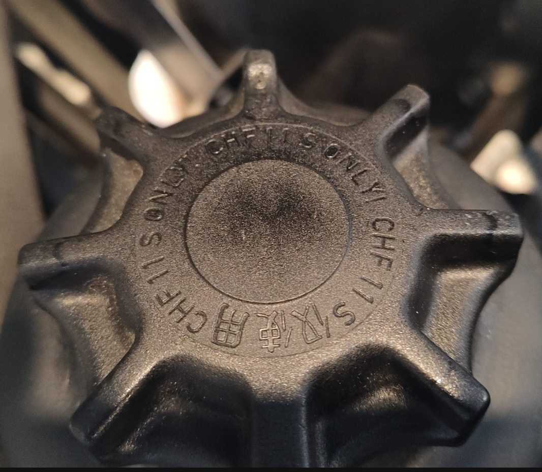

After replacing the reservoir, I opted to keep the original cap as it has the CHF 11S requirement on it. The OE replacement didn't.
Once the new reservoir was installed, I filled up to the Min line (the Cap has Min / Max lines ) and then worked to flush out any air or gaps in the system. Ran the car and often checked the level.
After I was satisfied the system was purged correctly, I filled 1/2 way to Max and called it a job...

For tip 2. I actually checked the level quite often, like twice per lock to lock turns and added fluid as soon as it would drop. Very important to not introduce more air in the system..
For tip 3, Absolutely don't do go lock to lock on the steering wheel with the car static. it's probably very hard to do with the engine off!! and with the engine on, it probably strains the pump.
In my case, I forgot to mention my work setup didn't require me to rock the car back and forth...
