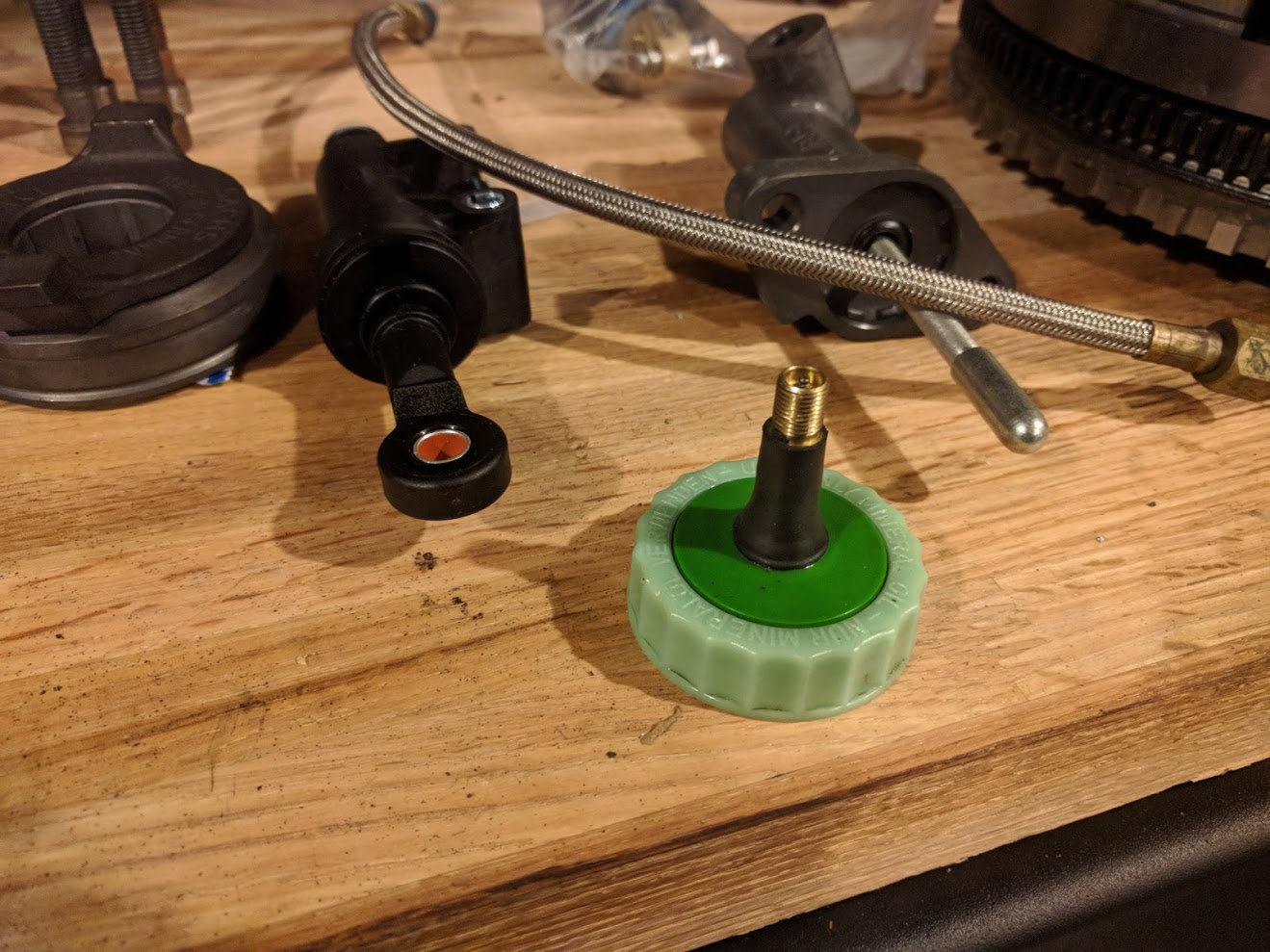

I just wanted to chime in as I am going through this job right now along with a Sachs 2.5 kit.
The OP mentioned the Motive bleeder to flush out all the Pentosin. Attached is my $2.00 solution. Considering we will not be res-using the green Pentosin cap this seemed like a good final use. These tire stems can be had cheap. I dont know the part number as I had one sitting around in my boost leak checker. Just drill the correct size hole and regulate your compressor at ~10PSI.
I blew about 4 master cylinders worth of some old ATE DOT4 Blue I had lying around and then continued to run pressure through the lines until the open end stopped sputtering. Recycle the blown fluid with your used motor oil.
