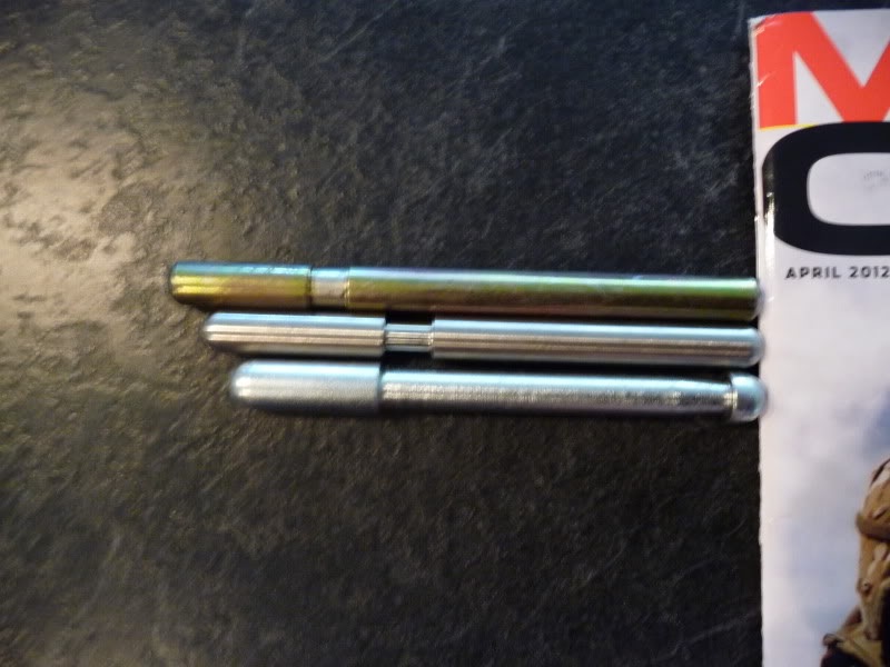

So after a bit of a hiccup I was finally able to swap my stock 996tt slave rod for an extended 2nd Gen Mitsubishi Eclipse slave rod. It's perfect!
The clutch engagement point with my Spec Stage 2+ clutch was in the top 10% of the pedal travel, which I didn't really like. It seemed like everyone had issues with the engagement point being too low with the GT2 slave rod so I needed something in the middle. I didn't want to mess around with cutting/modding my stock slave rod and Dgreen isn't selling any custom slave rods. So after extensive Google searching I found that an extended 2nd Gen Eclipse slave rod would be the perfect length and work with the GT2 slave. Without solid measurements I decided to give it a try since the Eclipse rod was only $15. Turns out, my google searching was spot on
Bottom is the stock GT2 rod, middle is the extended Eclipse rod, top is the stock 996tt rod.
I put some calipers on each rod:
GT2 Rod
Length: 91.12mm
Diameter: 9.04mm (big end), 7.05mm (middle), 9.04mm (mushroom end)
Extended Eclipse Rod
Length: 95.89mm
Diameter: 8mm
996TT Rod
Length: 102.77mm
Diameter: 8mm
The Eclipse rod is almost exactly in the middle of the two stock rods and is the same diameter as the stock Turbo slave rod. So it was exactly what I was looking for.
GT2 Rod
Length: 91.12mm
Length: 95.89mm
Diameter: 8mm
996TT Rod
Length: 102.77mm
Diameter: 8mm
GT2 Rod
Length: 91.12mm
Length: 95.89mm
Diameter: 8mm
996TT Rod
Length: 102.77mm
Diameter: 8mm

It appears both the stock 996tt and shorter eclipse rod were too short and are over-extending the slaves. They don't over-extend enough to push the piston out right away but I think it pushes the retainer clip out the first time I push the clutch down then after a few miles or upon removing the slave from the trans, the piston will pop all the way out. In other words, my experiment was an epic failure
Weird that both rods were too short when other people have ran the stock turbo rod or slightly shortened stock turbo rod with no problems
So now I think I need a longer than the stock turbo rod because clearly something is different with my bracket or clutch setup. It appears that EvoMS is now supplying a custom 120mm slave rod (vs the stock turbo 102mm rod) so I'm going to try and get something fabbed up that's around that length.

So after talking with VAGscum and DaveM at EPL I found that I probably needed a longer slave rod because of some difference in my clutch/throwout bearing setup.
With some coaching by VAGscum, I made my own slave rod by ordering an 8mm diameter 304 stainless steel rod from McMaster-Carr and cutting it to size (123mm in length, almost 3/4" longer than the stock rod and about equal to EvoMS's new rod length, which is 120mm). I rounded the ends and even cut a notch into it like the stock rod, to hold the rubber boot in place. I was also able to rebuild one of the GT2 slaves that had over-extended (worst case I just pull the thing again and replace it, a job I can do in my sleep now).
So far so good. The engagement point is very high, like before, but I think that's the nature of my pressure plate rather than rod length. I've driven the car a bit and haven't had any leaks or blown apart slaves. So I'm pretty confident that a longer slave rod was necessary for my clutch setup (Spec stage 2+).
Basically what I think happened was that my Spec supplied T/O bearing had the longer ears on it (like the T/O bearings used for a single mass fw's). But used with a dual mass fw, it created some play (about 1/2") in the clutch fork. This necessitated a longer slave rod to make up for the play in the fork. So while shortening the rod may work for some people (and might effect the engagement point), in my particular case I needed a longer slave rod to make up for the slack in the clutch fork.
In any event, a bit of a PITA but the GT2 slave conversion is 1000 times better than stock so it was all work it. I'll just have to suck it up and get used to the new engagement point
A big thank you to VAGscum and Dave at EPL for answering all my questions and helping me work through this
