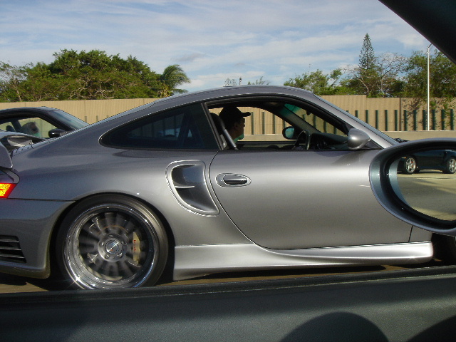

So Xico, to clarify, did you fit the racing GT3-RS uprights/ carriers/hubs on the front and rear or just the rears with custom TRG uprights/carriers/hubs in the front?
Also, don't the RS front wheel carriers require 380mm rotors? Did you upgrade to 15" brakes as well?

I was going to ask what kind of brakes are on xico's car but the pic was the answer. Looks like some of Brembo's finest GTR brakes are installed.
The car looks superb. All the mod's complement each other and it looks like one of the best turbo's around. Job well done xico.
