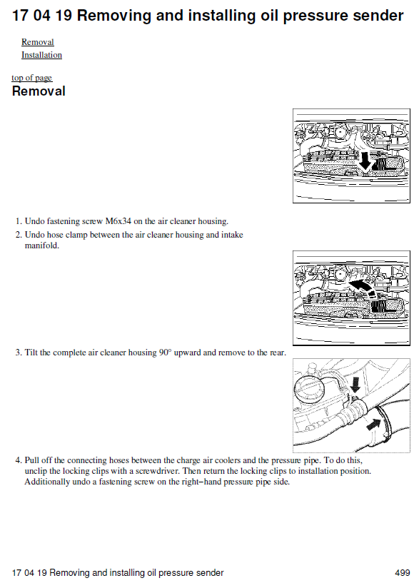

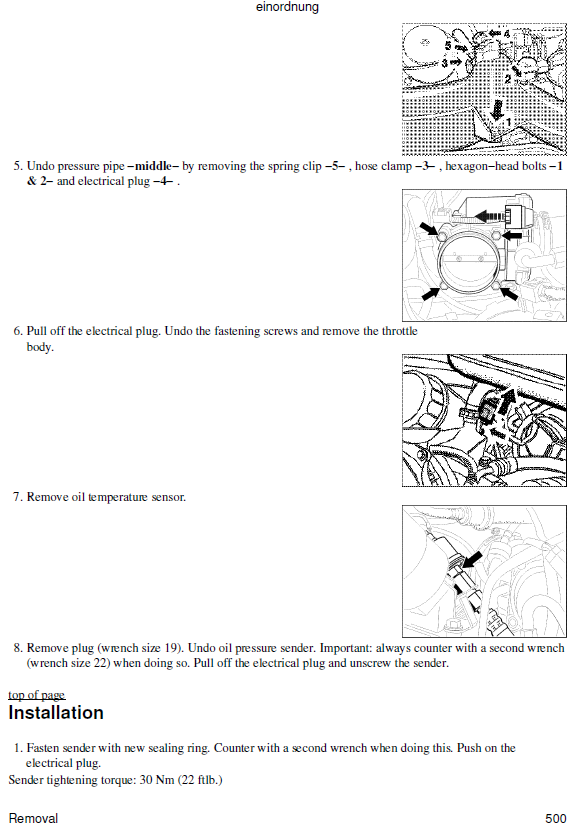

I had my 996tt at my mechanic last week and one of the things they replaced was plastic oil "funnel". I've been getting Oil Sensor Failure warning since.
I was sure they forgot to reconnect the sensor back when they finished work so I looked under the hood and there is unpluged cable on the left side of oil cap.
Where is the Oil pressure sensor connector? I can't find where to plug this cable.
I'll stop by garage next week but it's out of my way and I'm guessing this should be a simple job.
Where should I look? Pics appreciated
Thanks in advance.

By, and kinda under the drivers side of the y-pipe. Right by the throttle body. Take off the y-pipe to access, and if you need the room, the TB.

This might help...
Size:  63.8 KBName:  OilSensor2.png

Found it, pluged it and it works. Thanks guys.
