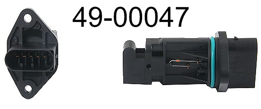

Knew it! $500 seems way high. If you'd like I can ship you the sensor and you can swap it out yourself. It'll be cheaper. Or you get the sensor and have your mechanic put it in. Very simple, just two screws and a plug.

Maf sensor and mass sensor are the same thing. MAF stands for Mass Air Flow Sensor/Meter.
Here is a picture

yes that looks like what he pointed to...

go get yourself some electronics cleaner spray from radio shack and pull the maf out and spray the sensor and connectors really well. Let it dry for about 30 minutes in dry climate or an hour. Then reinstall and you might be ok without spending any money. The MAF may just be fauled a little.
