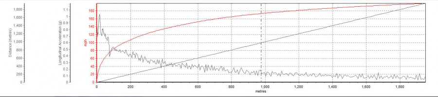

Actually my car had an issue at just under 1/4 tank marker. I suppose I had been driving it hard
I done some testing on 14th October after getting the car back. I ran at Bruntingthorpe which is 4 mile track with 2 mile straight. I only ran at 1.3 bar because when I tried at 1.5 bar it popped the hose of the BOV (these are now clipped on securely). At least it was at the end of the run.
Attached are the graphs from that run.
In summary the car did (1.3bar)
Speed v Time
0-60 3.2
0-100 6.6
0-150 13.7 ( with two persons in the car we did 14 sec dead as well)
0-160 15.8
0-170 18.4
0-180 21.8
0-186 24.0
0-200 30.8 (we did have a 29.8 but no sd card but have photo).
I saw 207mph on the dash at 1.3bar, so just around 200 on gps.
In terms of speed v distance (1.3bar)
1/4 mile 135mph
1/2 mile 165mph
3/4 mile 182mph
1 mile 192mph
1.19miles 200mph
AFRs
Under full load at 200 they were spot on 11.45 so there is room to squeeze more out of her.
IATs
Ambient was around 12c. I ran 4 continuous circuits (16 miles) under pretty much full load down the straight and half load down the back area. IAT started at 22 and rose at 200mph to 48-51 on most of the runs, but running to just 186 they stayed around low 40s.
I could have pushed harder but it was a shake down test since I done the gps 200 (digital dash 207) in 1.2miles.
I am running at Vmax in a few weeks at the same place.
All being well I think the car can run (@ 1.5bar) probably 21-22 sec 0-300kph and probably close to 200 in the mile.
