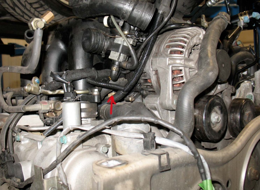

Item # 24 is the temperature sensor part#996 606 410 00 (about $21.00). Take a good look at the wires connection. It is a difficult part to reach because of the location behind the alternator.
