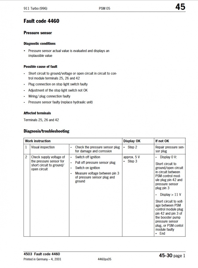

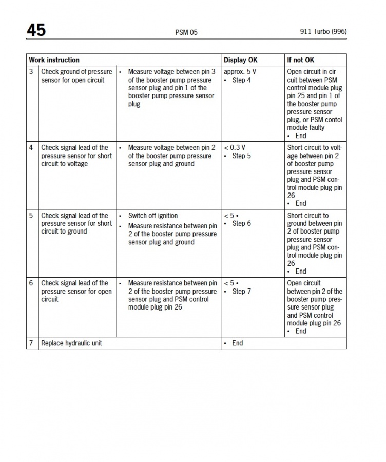

There is some easy troubleshooting you can do if you got a voltmeter.... The pressure sensor they are talking about is located on the PSM itself (plug with three wires, one black, one red and green, one black and brown)
