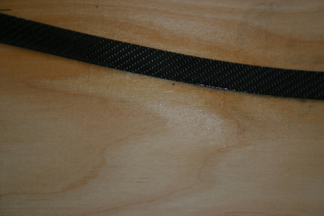

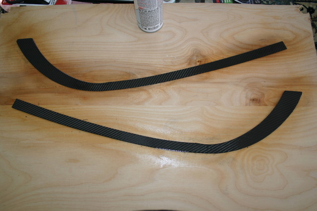

Here are a few pics:
Setting up to spray
Spraying:
Close up after a few coats:
Then I used a 3M high temp automotive clear double sided tape to secure them...no movement or lifting and we had a hot sunny summer - I was actually very surprised they held up - I was ready to JB weld them down and figured I would try the tape to see how they did, as it was a lot easier....

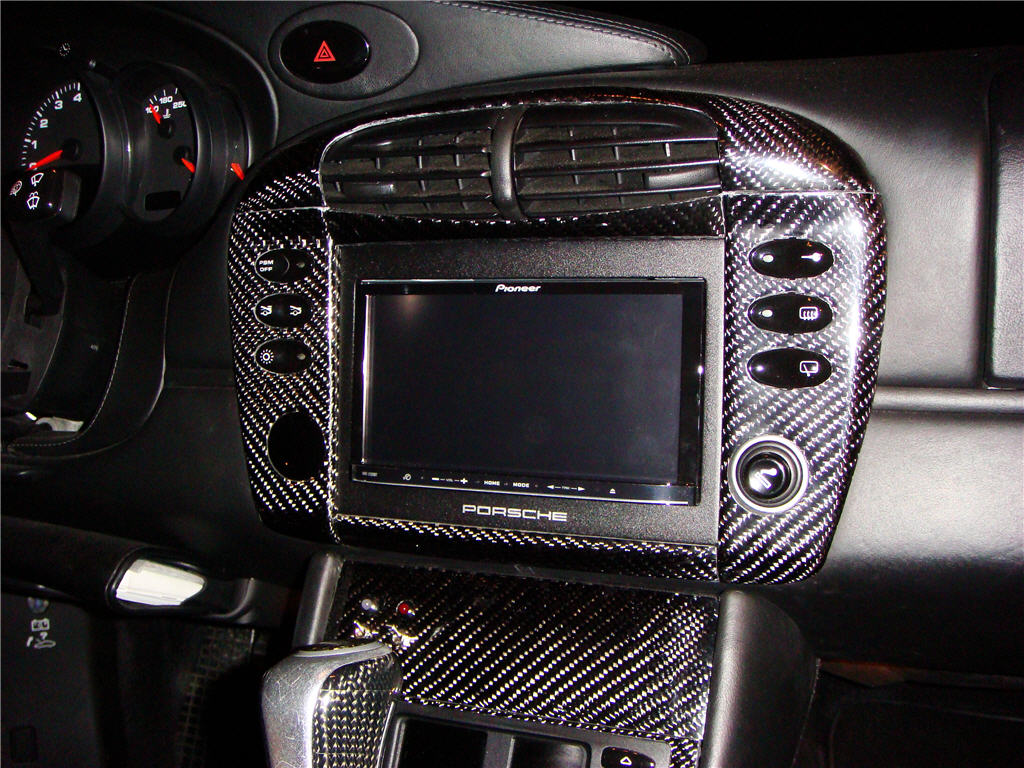

Not purchased pieces - every piece of interior trim that comes off.
Check this out for example: http://www.comtech.ws/Porsche911/DIY...bon_fiber.html

I bought the carbon fiber from here: http://compositeenvisions.com/ and the resin I get locally because it is hard to ship. Get the high UV protection stuff. I also paint all pieces with automotive clear-coat now to keep the UV protection really high.
