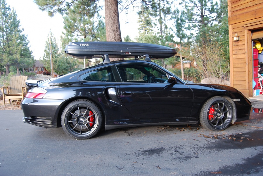

I got these from Damon. They are wonderful wheels. I think I want a summer set now! These are with the LM 60's.
