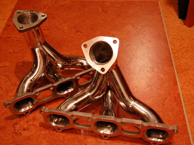

I bought two pair of headers to compare them. The one pair was only 225$ and they are very nice. ... That was cheep if I get any better spool I am good with 225$...I think I will put them on before spring and see if there is any difference

I bought the headers just to see how well they were made... I actualy bought 2 pair and was going to do a write up on them but haven't had the time yet.... The one pair, the 225$ one was surprisingly well made. The welds were very good and I was surprised. I will post some pictures

It's not always the welds that are bad. If the stainless (if that's what they are) is too thin, they will crack...guaranteed...

some pictures

i was wondering if you could feel a seat of the pants improvement with headers. i have a tip so i will probably only go up to 525 hp ....

Nope. These aren't like big block chevy's that really respond to headers. The 996tt factory headers actually flow really well up to 700whp or so...

It wont hurt to add headers to your tip since you already have them. But you wont see any benefit at the power level you want to head towards.
