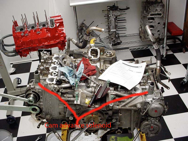

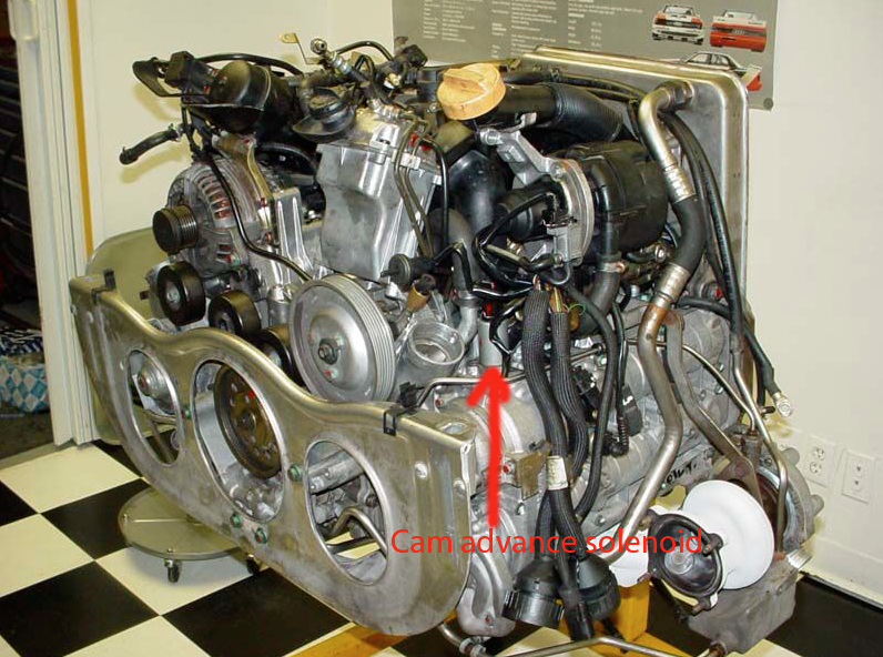

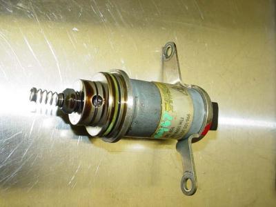

First picture is a solenoid, second and third is the location of the two solenoid for the cam advance and the last the picture the valves lift solenoid location....
But wouldn't a variocam issue throw another code?
http://www.renntech.org/forums/index...e-fault-p1349/
Agree Paulumn. I post these picture for info. The vario cam can be test using Durametric "drive link" functions....
Lots of work on this link related to variocam...http://www.renntech.org/forums/index..._1#entry125986
