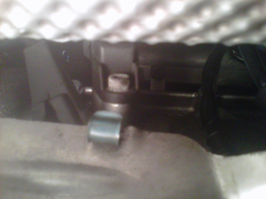

Did you try to rev the car passed 3500-4000? because at that point the cam retards on the varo. If the oil rings on the end of your intake cam is not holding the oil psi the cam will not advance and cause the problems you have. The cam sync controls injector and the dme uses that input for timing as well. The time this happened to me I did not get a high input code so hopefully its just the sensor. I will see if I have a spare one in a old blown up motor (lol) and take a pic or two of where the sensor is in the car.

Pics would be great! I really appreciate all your input here in my thread!

Well it looks like you will need to get it from under the car. I have one used cam sensor that in the bank 1 valve cover. If you do some homework and its the same I can drop it in the mail for you.

Hmm... I can't see a damn thing in that pic! haha! Maybe I'm just not sure what I'm looking for.
Let me tear into things (perhaps tonight) and I'll let you know. And thanks very much for offering up the CPS!

LOL. that blueish clip holds the primary O2 wire and that allen head bolt above that is holding in the sensor. It is also right above the #4 coil.

The blue arrow is where the sensor bolts in.
