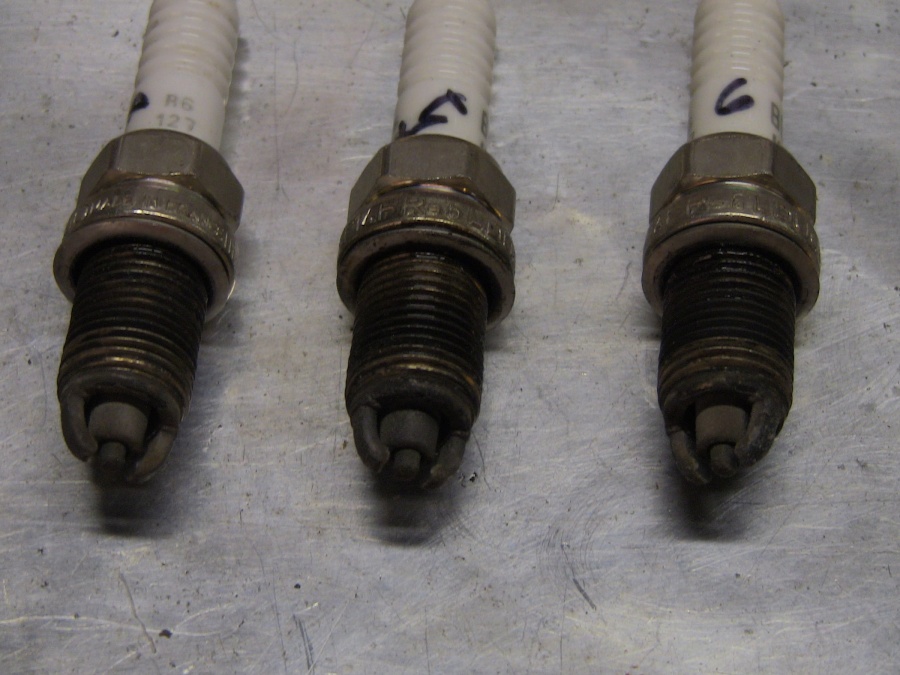

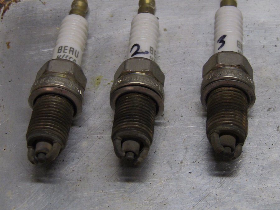

I just did my plugs and coil packs. Alex "Sharky" Ross at Sharkwerks recommended using Bosch FR6LDC plugs. They came pre-gapped at .025. The plugs have multi-grounds. He told me if I use the NGK BKR7EIX, they will require changing every 5,000 miles or so. He said these should last 30K.
I was going to use the NGK's as recommended by this thread and others, but my plugs don't look lean. #3 and #6 (which was pulling P0303,P0306 codes-misfire) look perfect with a brownish tint. Others were brown/light black. So, I don't know if I would benefit from a cooler plug. See pix.
