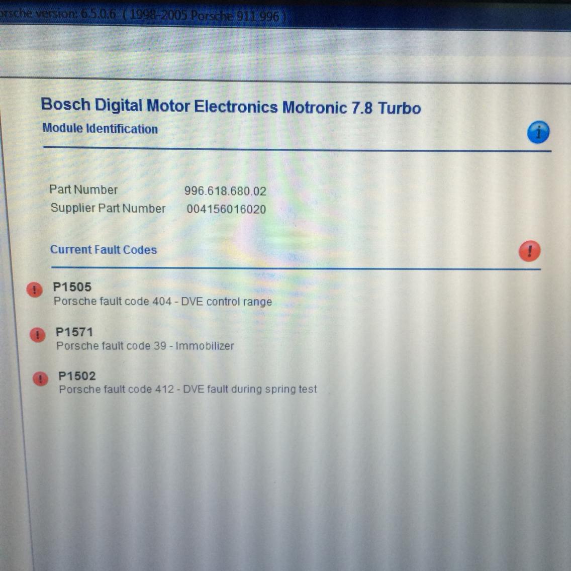

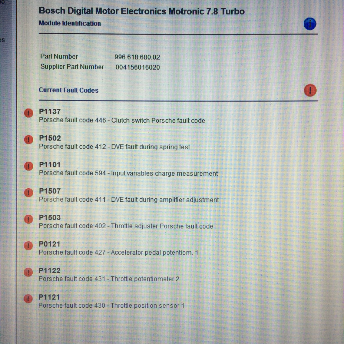

Below is the read out from durametric, both at idle, the left hand side was pretty abnormal, and the right hand side was last night when it was fine and I drove it home, but still, I am still worrying it will come back again, I will be joining Track day after couple weeks...

Clean your throttle plate off. I got half of those codes. Spring test fail if that happens you can't drive the car. You can't touch the throttle without removing the electrical connector if you do touch it you will damage it if you don't disconnect it.
Again to you it looks clean but the other side is not.
