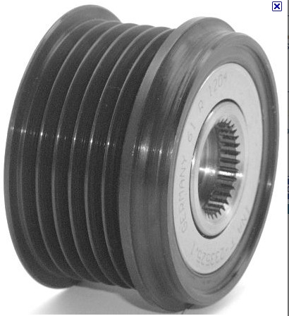

Originally Posted by gearhead
Thanks jp, it's the feeling of the clutch kicking in and the voltage returning to normal is just making me wonder if it's the clutch slipping or the voltage regulator not telling it when to kick in or out.
Curious if the clutch is just mechanical as spinning weights that at higher rpm it grabs or if it's electric like the ac condenser and receives a electric signal to engage.
Anybody know for sure?
No there is not electrical connection to this clutch it is only mechanical not like the A/C. The part# of this clutch is 996 603 152 50 see pics....
