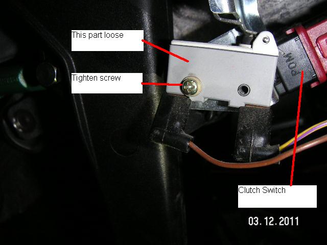

I only have 2 keys and both have the remote. I did tried both keys and even used the key to manually open the door thinking maybe is the alarm stopping the car from starting.
See the pic for the loose part that I tighten by the clutch. It look like a switch and not relay. But it is not the red/black lever switch that is sensing the clutch position.
Not sure if this gray part has anything to do with the clutch and if itis loose, could it cause it not start?
