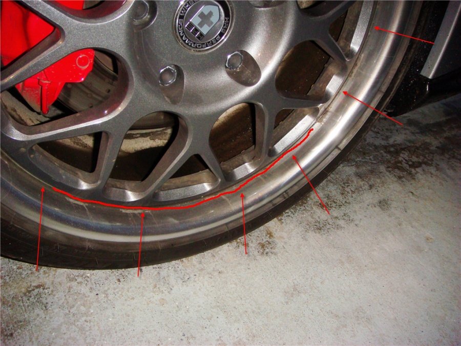

Yep, same here - HREs. Violent vibration at 75 MPH in the rain. I contacted HRE and suggested they had a design flaw. They said: "Oh no, not us. Take your wheels back to the vendor so he can check them. If he thinks they are OK, then you can ship them back to us for evaluation. Then, if we do indeed find a problem, maybe we can work something out." I told them, I would be happy to concede that there is nothing wrong with my specific wheels and that this was a design flaw; if it turns out that my wheels are indeed flawed, I will pay for new ones. I haven't heard from them since.
So, I filled the outer slot in the wheels with epoxy resin (same as what I use for CF work) and re-balanced the wheels. In the rain - absolutely perfect. I won't buy HRE wheels ever again.

Exactly where did you fill in with the epoxy? did you try the water chanel diverter above?

Thanks for the option HRE_Guy, I'll be calling when I get back into town. The picture below shows where I added the resin - it is even all the way around the wheel. I used resin instead of silicon because I have no intention of removing it (not sure why you would want to) and it is totally invisible unless you know what you are looking for. Sorry for the pic, it's raining (again).

Th issue with certain HRE wheels is that water collects in the lip. It is totally repeatable and consistent - in the rain. On dry roads everything is beautiful.

So you added it between the center and the rim? Not behind the center? Yeah I would like to talk with you. Now I am curious.
