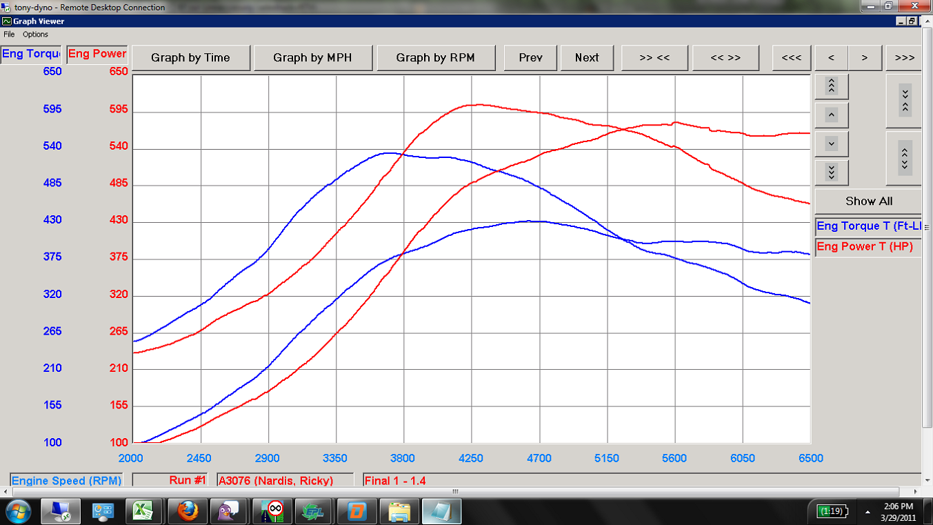

have put about 800 miles on the car...the thing is out of control....just a complete animal all over the place....virtually no loss in driveability...the clutch is on the heavier side but thats about it....the thing is scary fast....thnx again tony!

Originally Posted by Tony@epl
Spot on... good math skillzz . 589 I believe was the high pull with 600+ ftlbs.
I know there has been discussion lately what the limit of the stock fuel pump is.... This is 100% the limit of a good working stock fuel pump.
Specs
Alpha 3076's with billet wheels (1.3 bar)
93 oct pump fuel... NO METH
USP Inlets (very nice piece!)
Europipe exhaust
72lb injectors
Custom EPL Tune
AWE IC's and silicone hoses
Ill post some dyno plots shortly.

What were the air temps when you were dynoing??When Tony was connected to my car at Kelly Moss on their dyno,,Tony said I ran out of fuel and needed another fuel pump..Dyno room air temps were in low 50s then...As. I started a thread after that......I thought those 3076/billet Turbos flow alot more air then my K24/18gs??? Plus you made more HP+ TQ on the stock pump only...So, I am trying to get a handle on this because I am going back to Kelly Moss to have that done tomorrow.... ......Thanks
