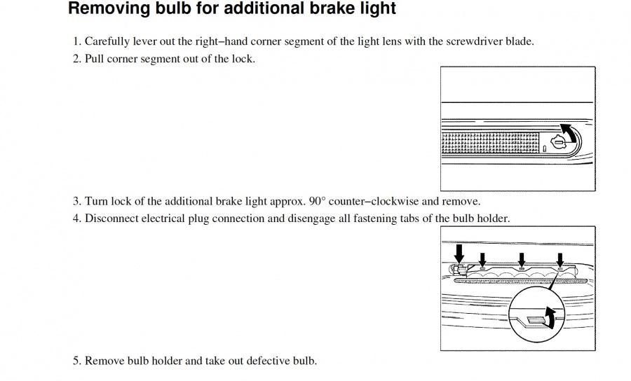

I need to replace my third brake light, and can't find any thread for it. Just need the instruction or link if there's any. Thanks in advance

to the far right is a little piece you prise out then you just need a screwdriver and pull on it done

I hope it help. Page 1141 of the repair manual. And some instructions here : http://www.maxspeed-motorsports.com/...stallation.pdf

awesome....thanks for all your help!!
