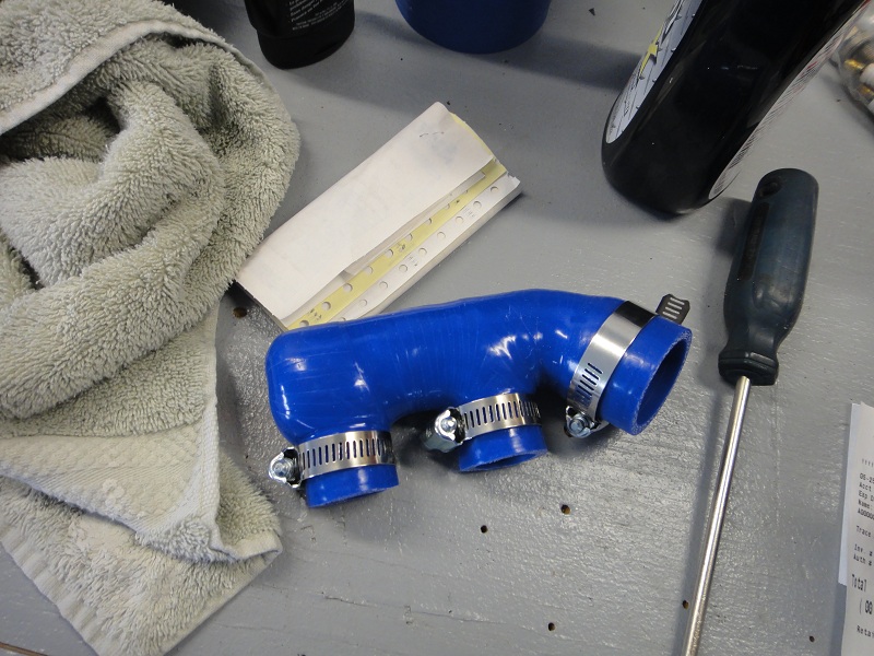

Well I ordered these boost hoses, and intake suction hose from ebay. Comes with a 1 year warranty so if they blow I can send em back. Will take higher quality pics and report back on the fit and finish of these guys when I get them. Wish me luck.

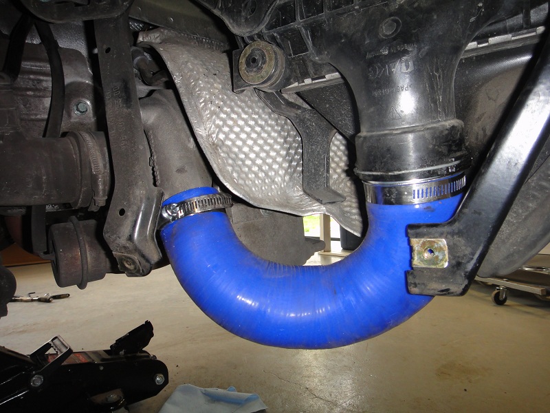

Install was good, product looks good. Had to buy my own clamps though which were about $1-2 a piece. As a previous poster mentioned, had to use thin clamps on the hose sections that go through the hole in sheet metal. I just used CV boot clamps (2 of them per connection) and those are low profile and tight.
Took it for a test drive and its holding the boost as expected!

OK here is what they look like installed on my car. I paid $297 for these!

Excellant; fitment wise everything was fine? No modifications required?
How do they compare to the stock ones size wise?

ebay hoses look nice but I thought that Porsche has specific clamps that are to go on theses hoses?? if so then why do you need to buy your own clamps? Are these the same as Ken's Forge hose kit? I recall Ken on another thread mentioning how perfect his kit was...why the need for cutting/trimming, getting clamps etc...etc... this shouldn't be happening from the kit that Ken said he has...if in fact the ebay and his kit are the same??? I am confused
