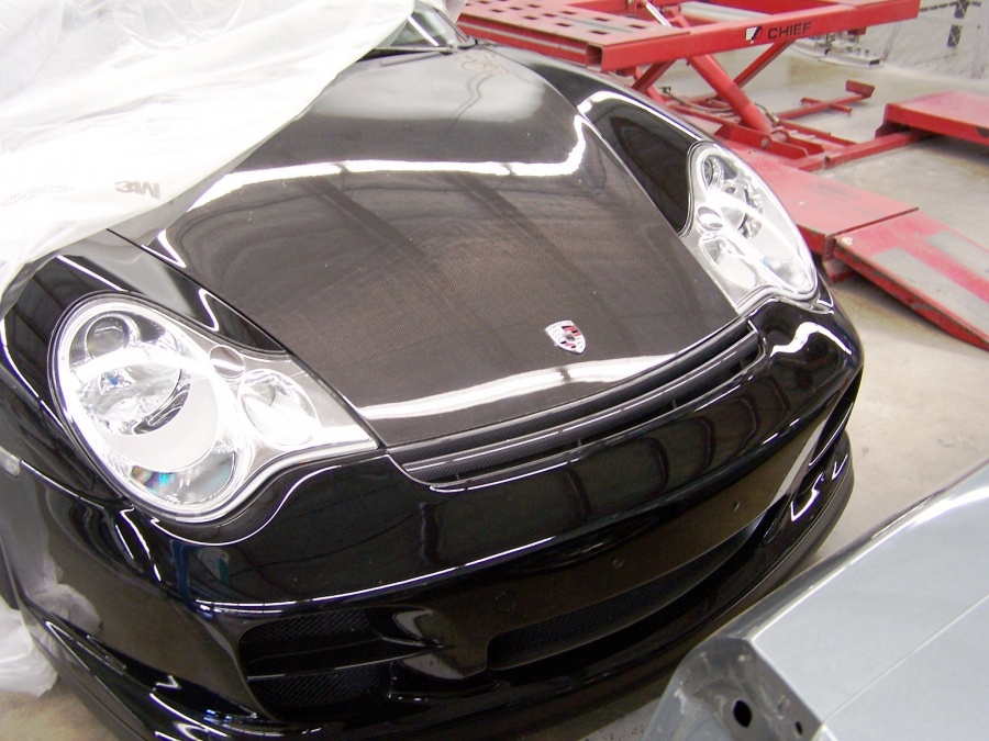

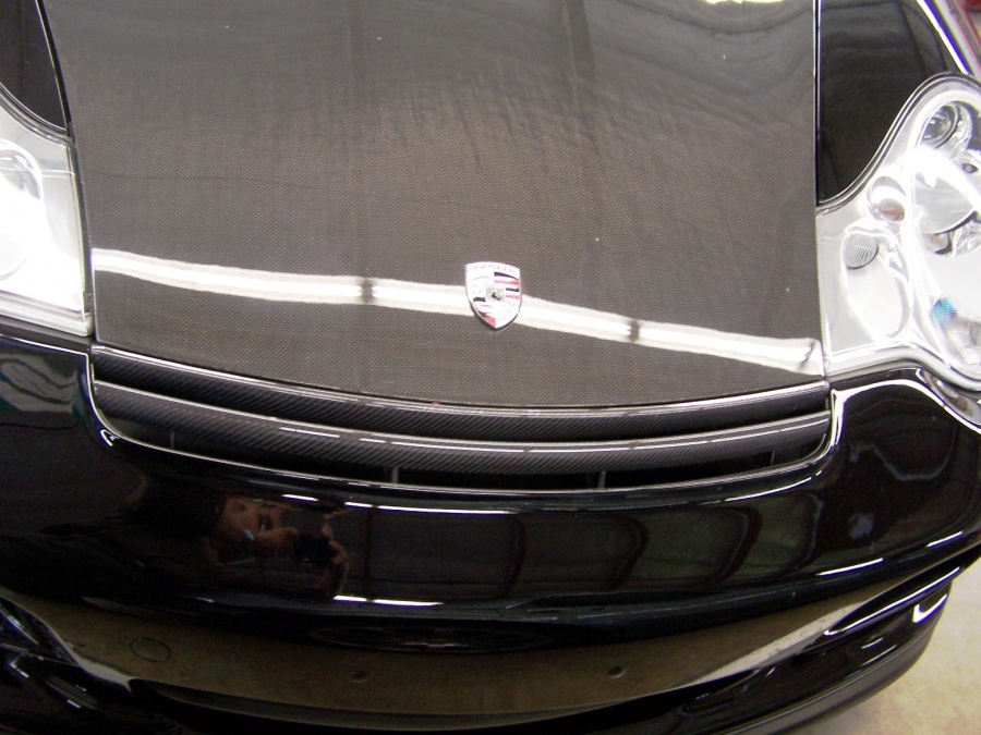

That CF nose grille looks fine, especially with CF Hood.
agreed the cf grille looks great! noticed you have gt2RS intercoolers...is that from the new 997 gt2RS...? do those require any modificaitons to install or are they a pure bolt on? how much better are they (in terms of flow and cooling) than your 996 GT2 factory units?

The IC's are from the new 997RS. Installation took about 8 professional installation hours. They fit right in, but the Ducts took 90% of the labor time. We did similar duct fabrication as illustrated on a previous post.
The CF hood was a one-off, weave over a thin fiberglass frame. We spend weeks on that one. You can find similar hoods listed in the for sale thread.

My friend put a carbon fiber hood and doors on his 996 GT2 for a 5 day race, and they barely held together long enough to finish before the hood and the driver's door started to delaminate. The doors were high-end too, not entry level. It kind of made me weary of carbon fiber, considering it's expense. I do LOVE the look though. On the other end of the spectrum, I saw the underside of the hood on the 2011 GT2RS and it is built like a brick ****house!! There is no way that thing is coming apart, short of a crash.
How much did it cost to make that hood of yours, if you don't mind me asking? It looks great!

That CF hood was a pure project of passion, done in my shop. If I would add all the time and materials spent, ... getting noxious already. If you like the look, buy one for a few hundred dollars and have it professionally refined to meet your needs.

On a bit of a side note; aren't 6-3 doors aluminium? Couldn't they be switched over to the 6-2`s?
Vents and hood are sick, btw!
Unterbergamotte? You and a friend laid that CF hood !!yourselves!! in your garage?
