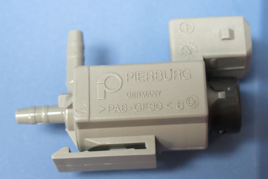

I also found a brand new valve in my stock (yes I am mental and suffer from hypochondria after becoming member of 6speed ) and I took some pictures for you so you can see the clip that hold it to the air pump mounting bracket....Lift up and it should come out!

This is fantastic! Thousand thanks for posting this. Without a reference point it would have been very difficult for me to figure out what's going on...
Mine sounds 100% different from that! So, this is a very good clue for me to hunt down from...
Given the cost, I'm going to just order the valve, install and go from there...

I've swapped the change over valve and could immediately tell that it was now sounding different (during Durametric actuation, the new valve is now "clicking" as it is in the video above--previously it hardly made a sound.) I don't have enough miles since resetting the codes to know if that's solved it for good. Will update again with more miles.

It's now been a two tanks of gas, and no new codes have been thrown. So from best I can tell, replacing the valve discussed above appears to have resolved the issue.
Thanks again for all the help. I hope my experience will give hints for others' troubleshooting in the future.
