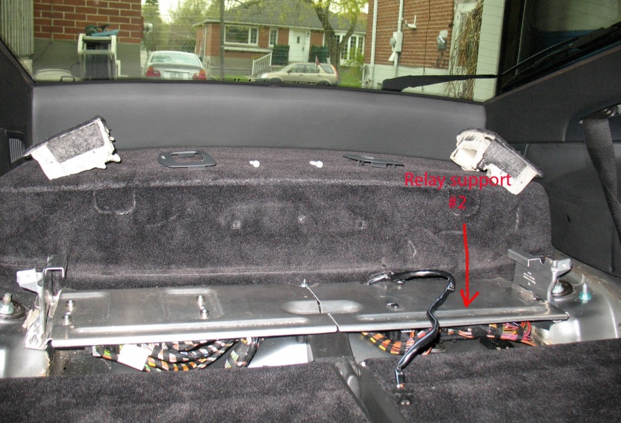

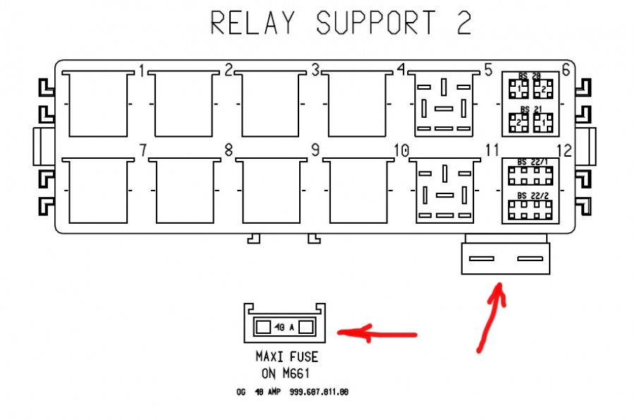

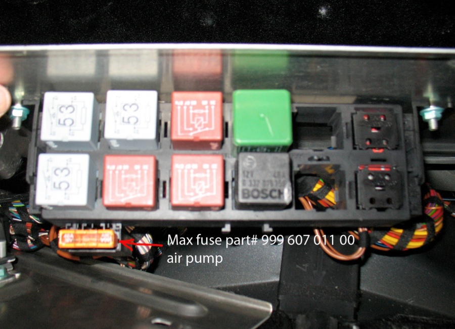

If you can get access to a Durametric or PST2 there is a function (drive link) to start this pump manually. Also there is a fuse , maxi fuse 40 amps part# 999 607 011 00, on relay support number 2 which is located behind rear passenger seat. See picture.

Very sweet.. I will check that fuse. Hopefully it is that. Sounds like a 92 probility on the fuse... Always check fuses first.
