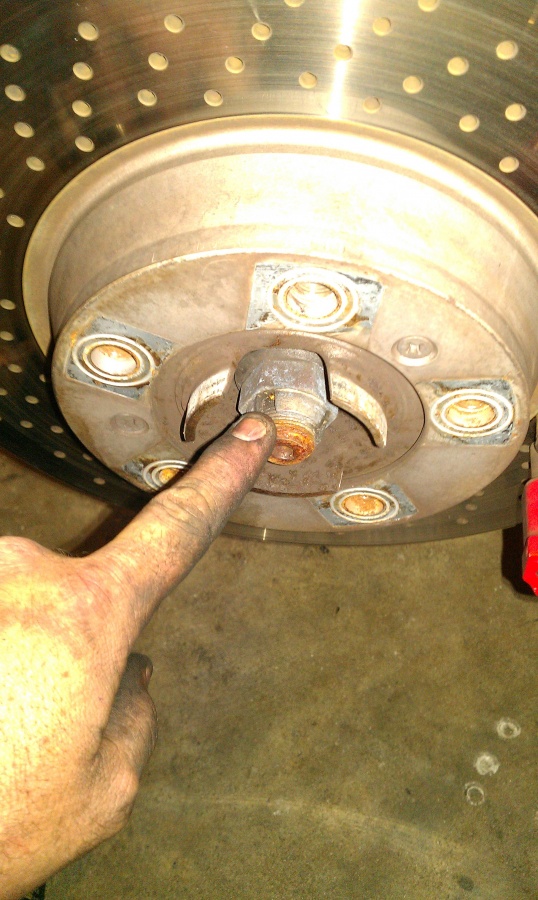

OK here we go....
first the back of the car is pie. take the wheels off and or go inside the car first. then on the interior remove the bose is equipped by taking the small front vanity cover off then there is a torques bit silver in color behind it. remove that and slide the bose forward and out. then remove the carpet and there is the top of the struts. those three bolts come out.
at the wheel. take off the bottom bolt that holds the cup to the lower control arm. then the sway bar links that go to the strut. then up and out it comes. they are not under and tension so no spring commpressor is needed. replace springs as necessary.
to the front, this looks a little scary but not that bad. when u look at it and say "does all that come off" the answer is yes. don't get scared at that point just make sure you have all the right tools and a quality 1/2 drive air ratchet.
when u start remove the below pictured bolts (lower ball joint, steering arm, and strut bolts on top.) you will need a 32mm to remove the bolt that holds the front axle in the hub. when removed is should come right out with a tap of a mallet.
when u take those items off lift the assembly off the lower ball joint and sit in on a 4x4 block or in your lap if your strong. when u do this tilt the top of the strut out of the wheel well and you have to have a buddy for this. have the buddy replace the spring while you hold it. WATCH FOR THE BRAKE LINE AND THE SENSOR LINES. THEY WILL BREAK IF NOT CAREFUL.
then reinsert the strut and bolt everything back together. it took us about 3.5 hours with a shop and all the tools
any questions let me know. if you follow this its not that bad.
curtis
