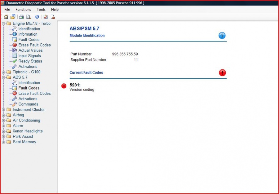

The overboost issue came back after 150 miles of the driving following hard battery reset. During the 150 miles, it boosted perfectly at 1.0-1.1 bar, then it was like a switch was flicked and it was back to 1.3-1.4 bar.
The car has had 3 full boost test at Porsche and a Indy, nothing hardware related seems to be a problem. Hoses are good, wastegates are good, ect. The ECU reset seems, in my mind, to indicate it's the computer only causing this overboost when something got screwy following the initial hose break, so Switzer recommended I flash it back to the stock file and see if it boosts properly at .7-.8.
I did the stock flash, it completed successfully, but immediately got a ABS and PSM error light when turning the car on (I guess normal but they should go away after driving a bit when the system relearns). However, I was capped at .2 bar and the car felt like it had 100hp immediately after the flash. 15 minutes later, the check engine light came one. I cleared the CELs with Durametric6, let it sit overnight, turned it on to idle for 10 minutes to full warm and tried another drive. Same .2 bar max, way down on power, and CEL came back on. So now it's back in the garage.
So now what? Do I try flashing the tune file again and see what happens? I'm really stuck here guys, and not able to drive my Porsche any more ! Attached are the fault codes and messages per Durametric from last night. I have no idea what they mean or indicate. Perhaps somehow that flash to stock was corrupted despite it successfully completing? There isn't anything that was messed up or problematic on the flash to stock. Your help is MUCH appreciated!
