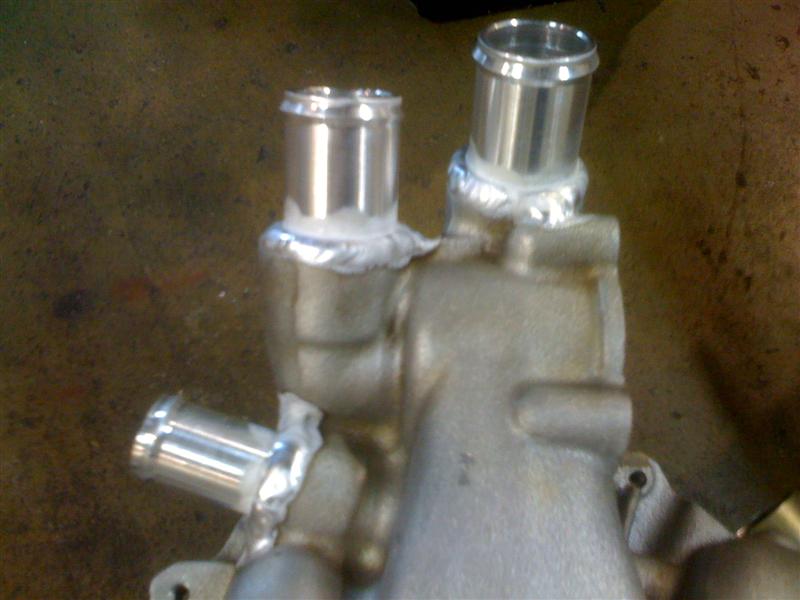

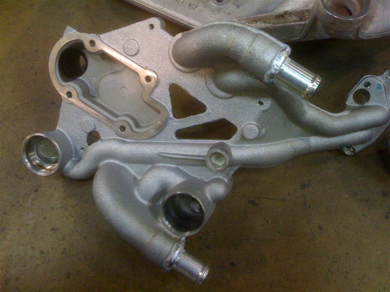

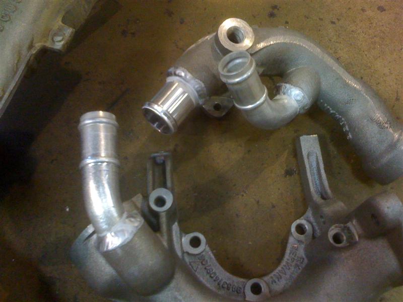

The top of the engine has to be cleared to get access for removal of the components that the fittings are glued into. Then the fittings have to be heated and removed and the glue residue thoroughly cleaned out. Once that is done the fittings, or in my case the aftermarket replacement kit has to be welded in. The fittings from the kit are made of thicker material. Either way, the original curved fittings have to be reused. Here are some pics of the 8 welded in fittings.
Name:  welded manifold 1.jpg
Name:  welded manifold 2.jpg
Name:  welded manifold 3.jpg
Attachment 163255
Attachment 163256
Attachment 163257
Huh big job. :-(.

I think that you have two choices. One is to pressurize the cooling system so that when the wall is breached by the drill, positive pressure of the coolant will carry out the chips. The other would be to drain the system (mine was involuntarily emptied anyway), pull of the hoses and put a rag into the hole to catch the chips, and then clean everything carefully before reassembling and refilling.
Note that some of the fittings shown in Landjet's post cannot be reached with the motor in the car. It is my understanding, however, that the ones on the water pump are the ones most prone to failure.

I ended up getting the hose fittings welded in the upper manifold just like Landjets 2nd picture. I'm hesitant to get it on the track for another DE until all of the have been properly pinned, but that's another shop bill. After this work I had a slow drip drip that turned out to be the bearing leaking on the water pump, so back in for that.
Car is back to normal and rips like before. No issues with head gaskets or the likes. Just make sure they get all of the air pockets out of the coolant system.
