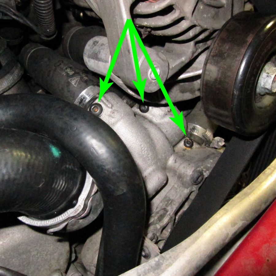

Hose and pump update
I had the split hose replaced, along with its neighbor (two hoses on left in the photo), along with the corresponding hose on the opposite side of the motor. My tech has found a way to do the "Sharkwerks" fix on the fittings with the water pump in the car. He removes the airbox, alternator and idler pulley, and can then drill/tap the fittings in the car. See photo below.
Labor was 3.25 hours to replace the 3 hoses, do the fittings, and refill the system. YMMV, especially since he always seems to undercharge me for labor.
