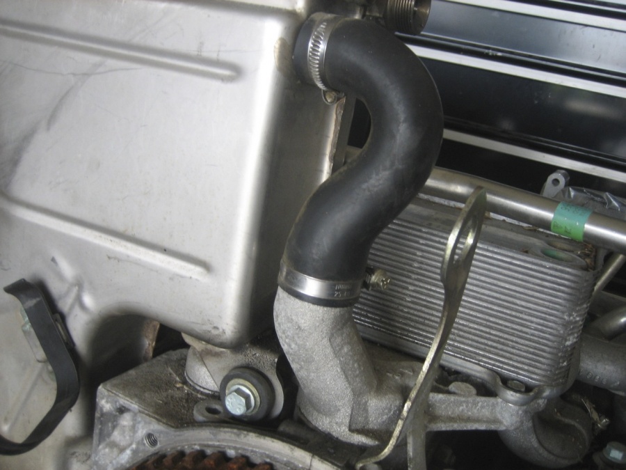

In my car the line vent hose (35) in the draw attach, in one side is connected to the oil tank container, but the another side is loose and I can't find where to be cennected? I removed manifold and everything around manifold included the throttelbody and I can't see wheres to be connected.
Any idea if the other side is loose is as it should be? or must be connected

It connects to the inlet pipe(between the MAF and the split down to the turbos)

is this it??

nop, look the pdf file that I posted or look the picture that I posted

There are three connections in that area......the main scavenge pump return back to the tank, the PCV cover breather, and the tank vent breather that goes back to the turbo inlet/intake. It's the latter of the three.
-Scavenge line is the hardline
-PCV line was shown in picture via pumptech
-Breather line is a rubber line that connects to the tank at the top-rear port on the tank and goes to the inlet.

Here, I just googled this picture of an AMs intake(for example purposes only).
you can see the hose connected to the tank and bent out of the way....it connects to the open port on the inlet located just above where they have the white line pointer.

Thank you RennFab I found the conection!!!!!!!!
