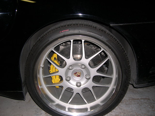

Other alternatives,
- Find a way to pull back the liner (And996tt's approach or reshaping with heat?)
- Larger shim to push out the wheels and "ease" the arches
- Depending on wear in the bushings you may have enough slop in the back suspension to allow movement/rubbing.
BTW, what make are the new tires and do you have any suspension upgrades? Attached is where I was at with standard springs and the 305's.
