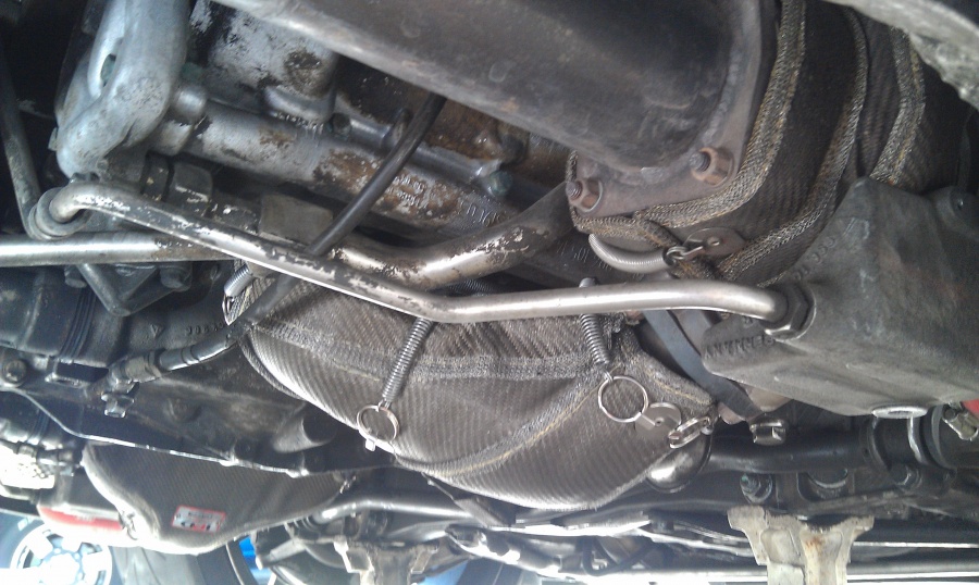

IPD Header Blankets
I have been contemplating getting header blankets for some time. Today I finally decided to pull the trigger and met with Turbo Mike at IPD. He installed some of his latest header blankets and OH MAN!!!! What a difference gentlemen. First off the boost response is much quicker than usual. Alpha 28 are pretty quick turbos but with these blankets they are even quicker. When the turbos initiate they come in very aggressive, with me and Mike in my car (total body weight of 440lbs) at 22lbs of boost I am break tires in second gear. When before with just me in the car I would have a real hard time breaking the Toyo R888. I can tell you the car is much more aggressive from initial all the way up top. Its now a constant violent pull not just initially. Hats off to IPD for coming up with such a great mod... If you're looking to get a better spool time and constant pull all around I would highly recommend these upgrades.
