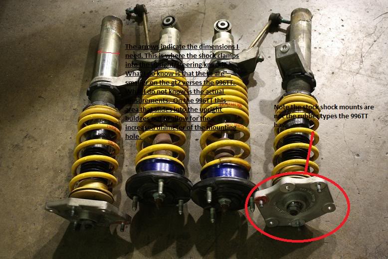

I have a question about the GT2 Upper strut mounts. As seen in the pic, circled in red, the GT2 strut mount has 6 threaded holes but only 3 are being used, have studs\bolts in them. Does it change the suspension geometry depending on the which 3 you use? I can you could have 2 different options by flipping the mount 180 degrees. Would that change camber or caster?
Flipping the upper mounts will change camber only.

Any idea by roughly how much?
Just looking at the picture it almost looks like one of the center bolt\threaded-holes is more centered to the center of the shock and the other is a little more to the side but that just might be the angle I guess.
