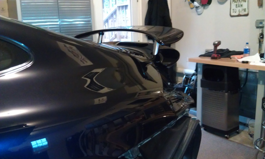

I don't know why I didn't think it would happen to me. Probably because this car is used very little. It is a pampered garage queen that has been driven <500 miles per year the last few years.
I was going to take some pictures of it and I like the looks with the spoiler up. I hit the interior switch to run it up and it goes up uneven. Looked under the ram cap and there is a leak.
I am not even going to entertain trying to repair this set up so it can fail again. I will remove it and thow it in the pile next to the original slave cylinder.
The fixed wing thing from ebay is already on order.
I installed the ebay fixed height kit a year ago. Worked out great. No more problems. Would do it again.

Repaired - permanently
After disassembling the ram I discovered I probably could have repaired the old hydraulic system. The cylinder was stuck in the bore. I'm sure with a clean up and bleed it would have worked fine.
Don't care I really like the looks of the spoiler up and now its up for good. If I ever want to go back I know I can.

is that the "extra tall" kit? or stock height, fully extended? it looks high, but it could be me.
Old Feb 23, 2012 | 03:33 PM
TurboTodd's Avatar
Joined: Nov 2008
Posts: 677
From: Cleveland Ohio
Rep Power: 67
TurboTodd has a reputation beyond reputeTurboTodd has a reputation beyond reputeTurboTodd has a reputation beyond reputeTurboTodd has a reputation beyond reputeTurboTodd has a reputation beyond reputeTurboTodd has a reputation beyond reputeTurboTodd has a reputation beyond reputeTurboTodd has a reputation beyond reputeTurboTodd has a reputation beyond reputeTurboTodd has a reputation beyond reputeTurboTodd has a reputation beyond repute
It is the extra tall kit

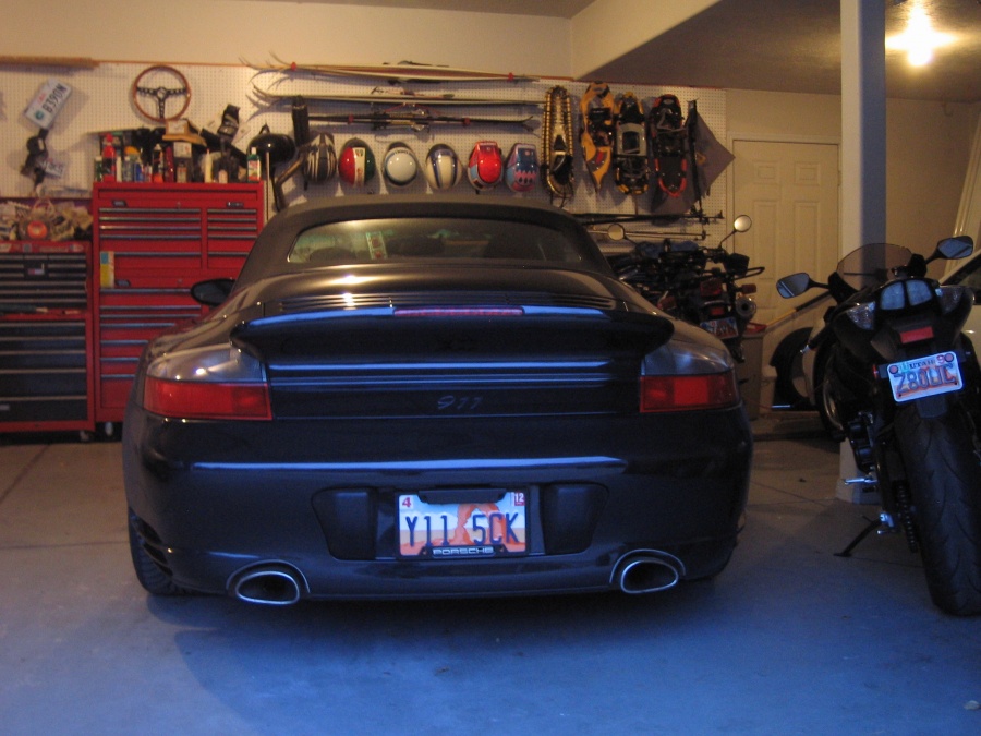

Mine failed for the second time with only 17K original miles so I removed the hydraulics and machined a kit to keep it fully extended. I got tired of the "up" look so I just took the upper wing and rams off the car. I like it better that way.

nice garage man.. wish we were neighbors.

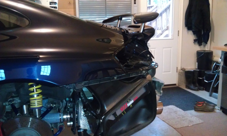

Here's another photo of the wing with the "extra tall" kit.
Looking good... perhaps that's how it should have been all along .
